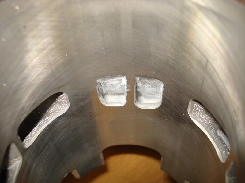

    BIG BIG, minor have you inlarged and widend the boost ports???? and youve hit the boost all the way through???
    lookin bangin mate
  3. MiNoR cOnFuSiOn
    Re: Ratty to Minty/125 to 172 Update 25/09
    ye, no finnished pics just yet as again, my gf's computer is a peice of shit and now doesent like uploading the pics you choose, rather picks some from another FUCKING FOLDER ENTIRELY!!! somthing to do wiht the camera's auto upload naming process and vista being vista i recon. but ye all ready to go prittymuch.
    its a 55 stroke and as it's running a pm pipe with a wider stub (now runs in at 32mm) with harsher exhaust timings ive had to lift the boost ports to open equally with the transfer ports. exhaust is obviously lower, higher and wider with a quicker opening time and is obviously enlarged all the way through (not just the exhaust flange area) timings im happy with now as its still a road bike at the end of the day, gonna munch some others tho.

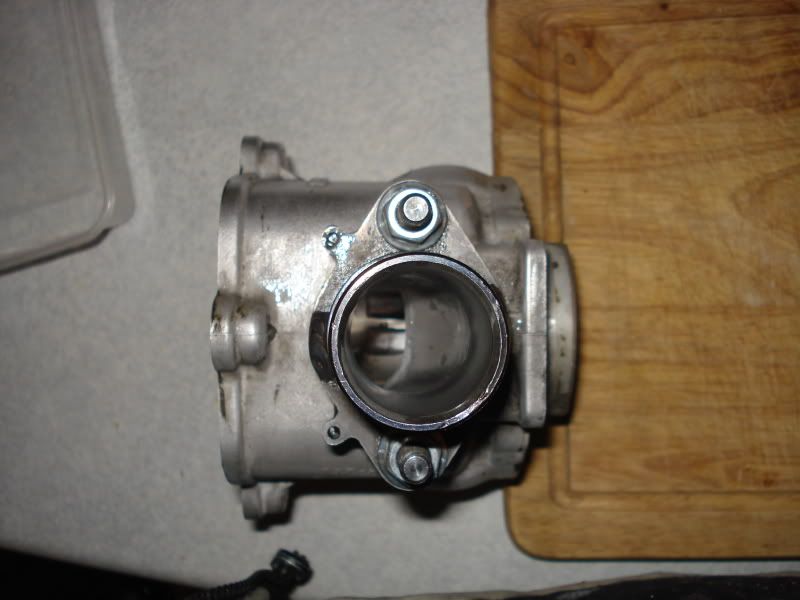

    Just afew pics of the Engine now its bk home after minor let himself loose on it lol :grin:
    Will get more pics up of it in the bike abit cleaner and wiv its T-Case wen i get it bk from Minor

    is that shit loads of sealant around the bore. that things gonna never fuck up haha

    is their point to lighting a clutch bell?
  7. MiNoR cOnFuSiOn
    not lightend really, maybe a few grams here an there.. its more to balance it as there ALWAYS well off.. it will blue up lovely once the engine runs aswell :D
    my premis is, if its easy and gives you SOME gain with no risk its worth doing it..
