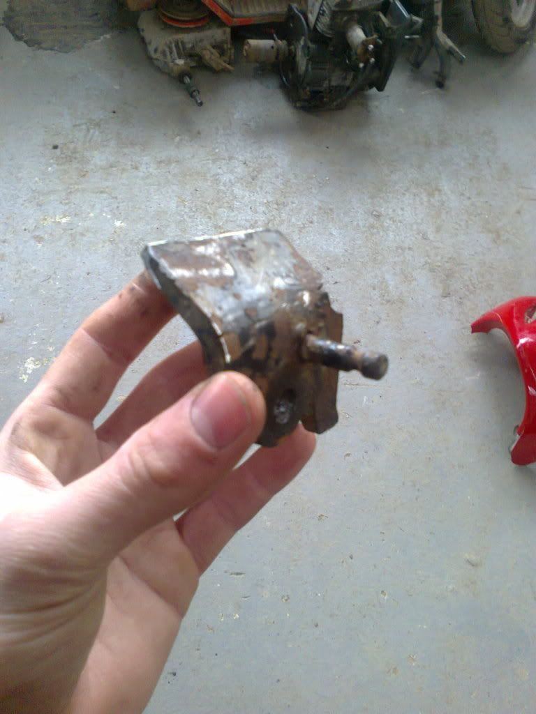

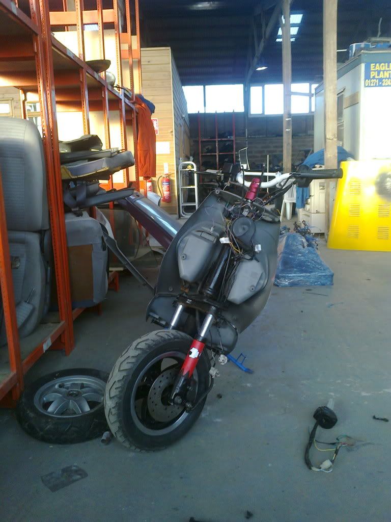

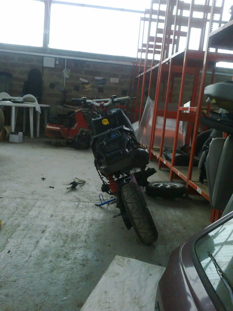

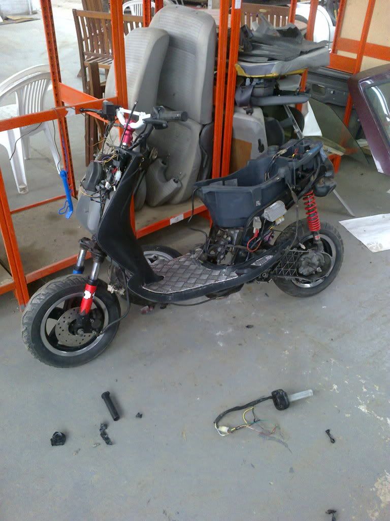

    i got round to fitting the side stand i cut the mount off the original bike it came off
    i then mounted the engine back in place so that i could work out the angle i wanted
    and then welded the bracket in place a vo la mounted with nice bit of lean :D

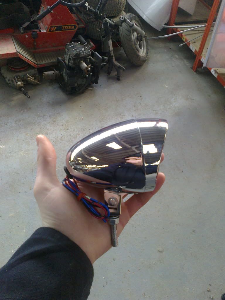

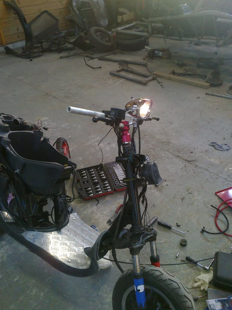

    more UPDATES

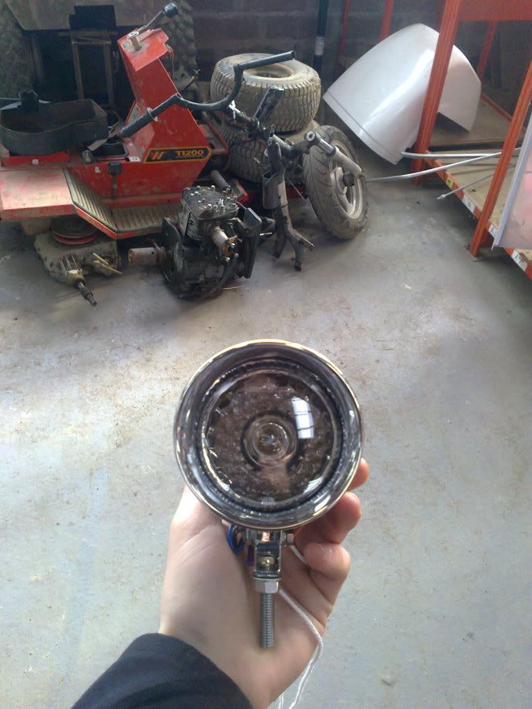

    well i had a parcel arrive this week from thailand :D
    and inside the box...........

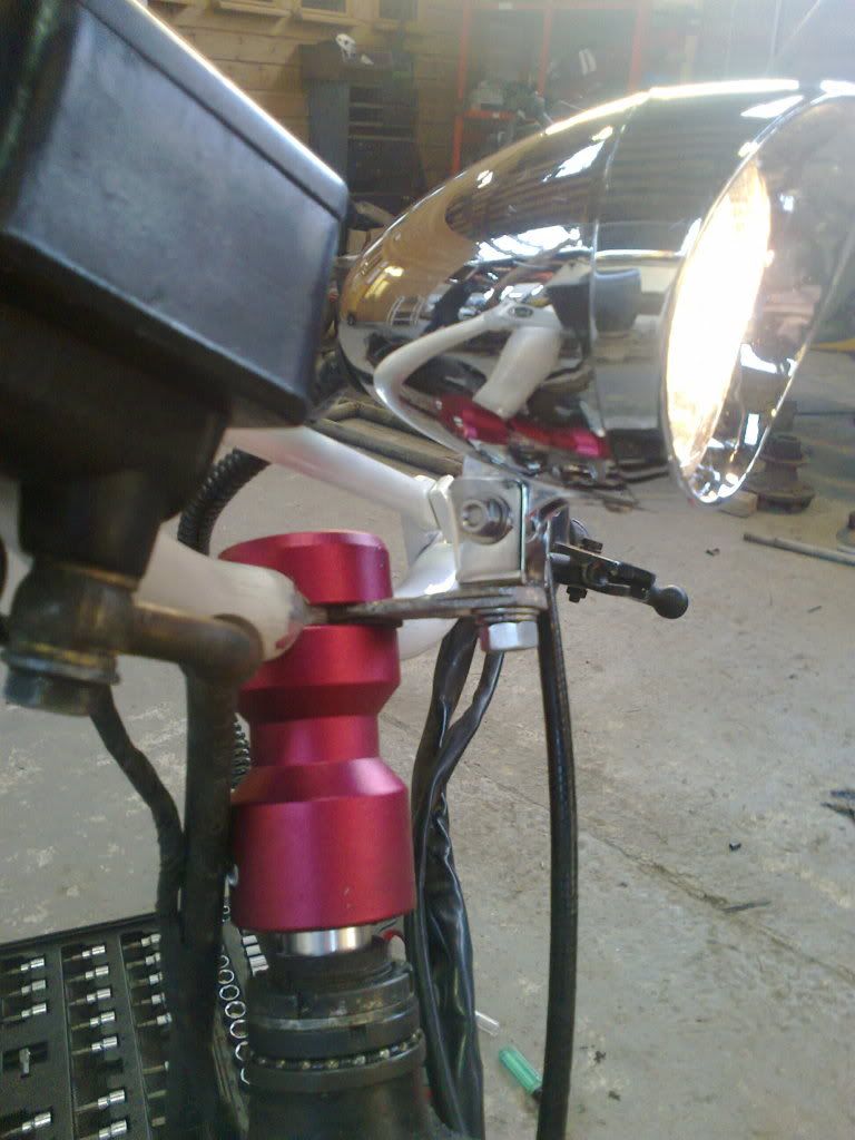

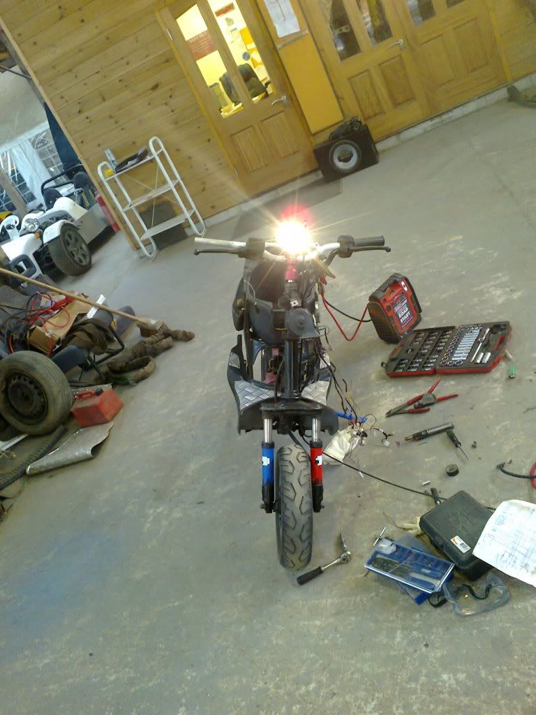

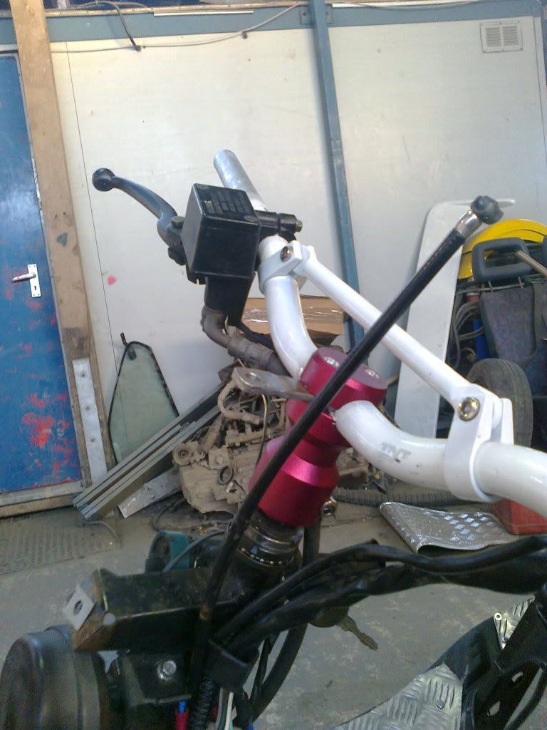

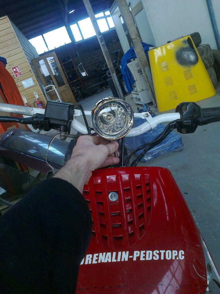

    had a rough idea where i wanted it to go
    i made up a bracket as my plan is to have it detachable for night and day time use
    and this is it fitted
    was a bit of a pain in the arse as the stem bolts were abit short and ended up ripping some of the threads out :( so i drilled out the top of the stem so that the bolts went further through :) and bosh job was done
    all comments welcome

  12. rems
    rems 2000 pac man zip
    541
    cheers dude i had to think of an idea for the headlight due to the fact it would fail mot without one :( so made a detachable one so i can show off the bar conversion as in devon people here think that a race pipe and derestricted is a tuned moped so im showing how its done :D

    love your pac man idea mate and that light looks good is it led
  16. rems
    541
    cheers dude and no its the mirrors at the back of the light that makes it look like it is lol
