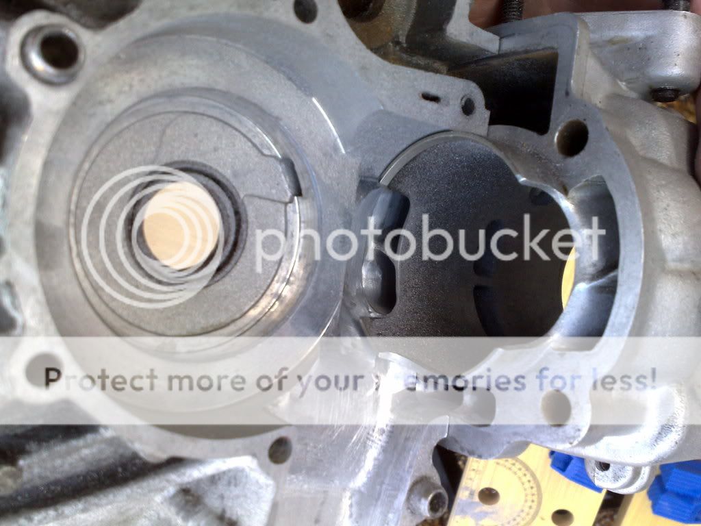

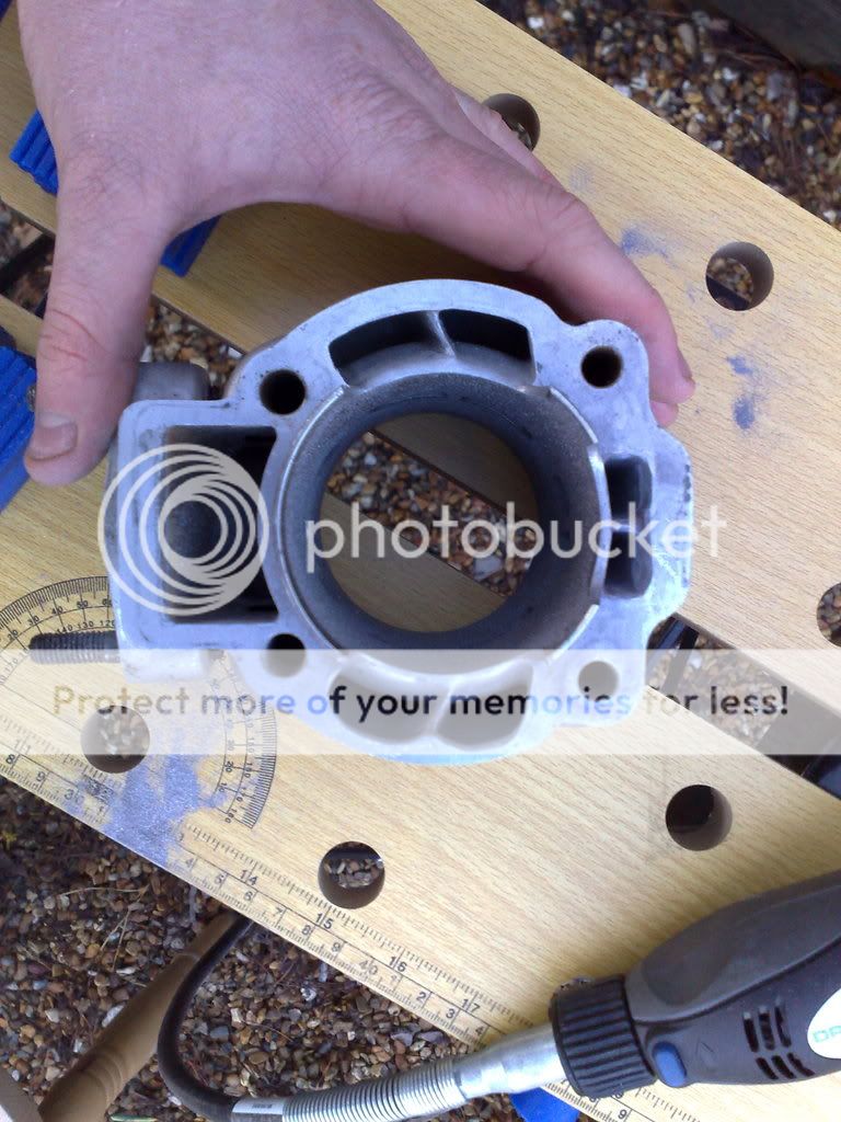

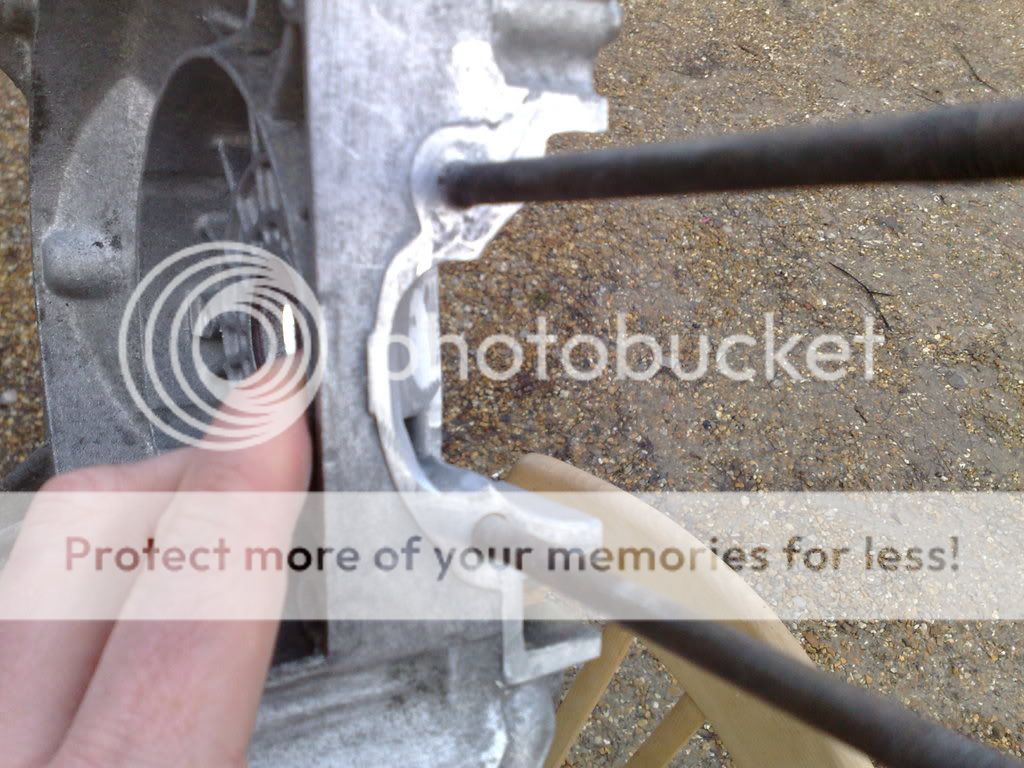

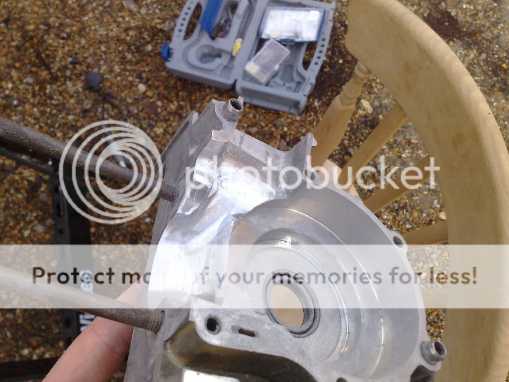

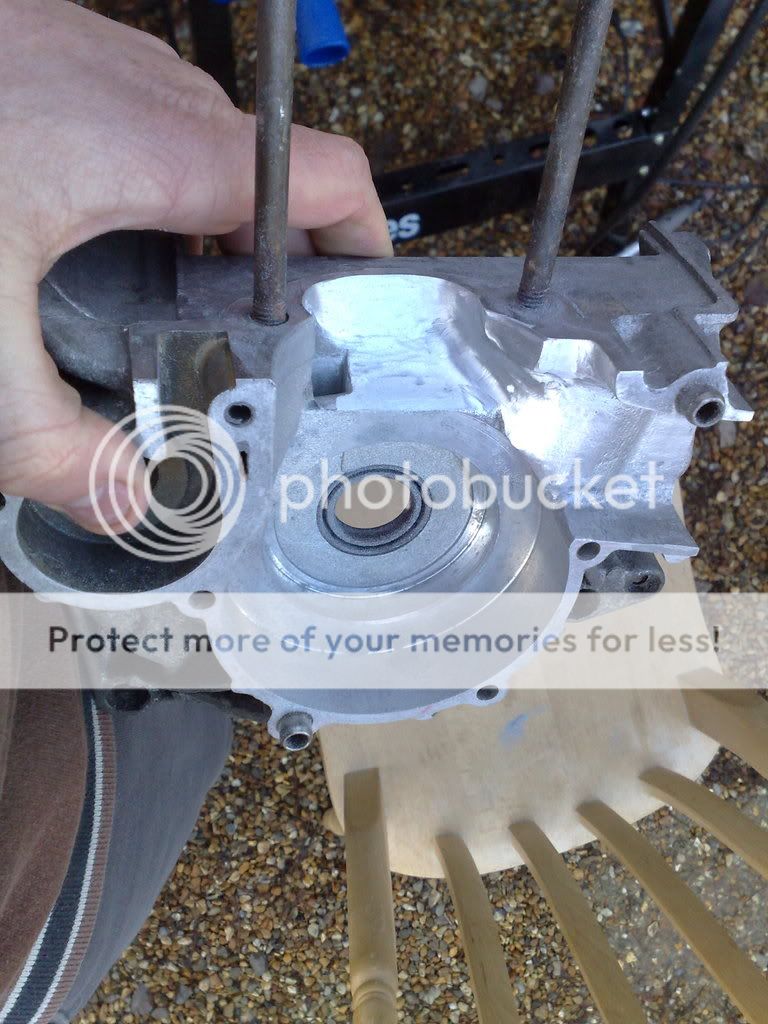

thats ghetto as fuck haha! love it si work looks good, pictures are quite hard to see but is the bridge in the transfer feed slightly blocking flow from the cases? looks like you need to pinch the edges in a bit more to make it less curved if that makes sense
when you porting cases, do you grind the case back so that the transfer matches the case? I'm thinking of doing it to my rg, just purchased a spare set of cases so trying to gather as much info as possible before I touch it

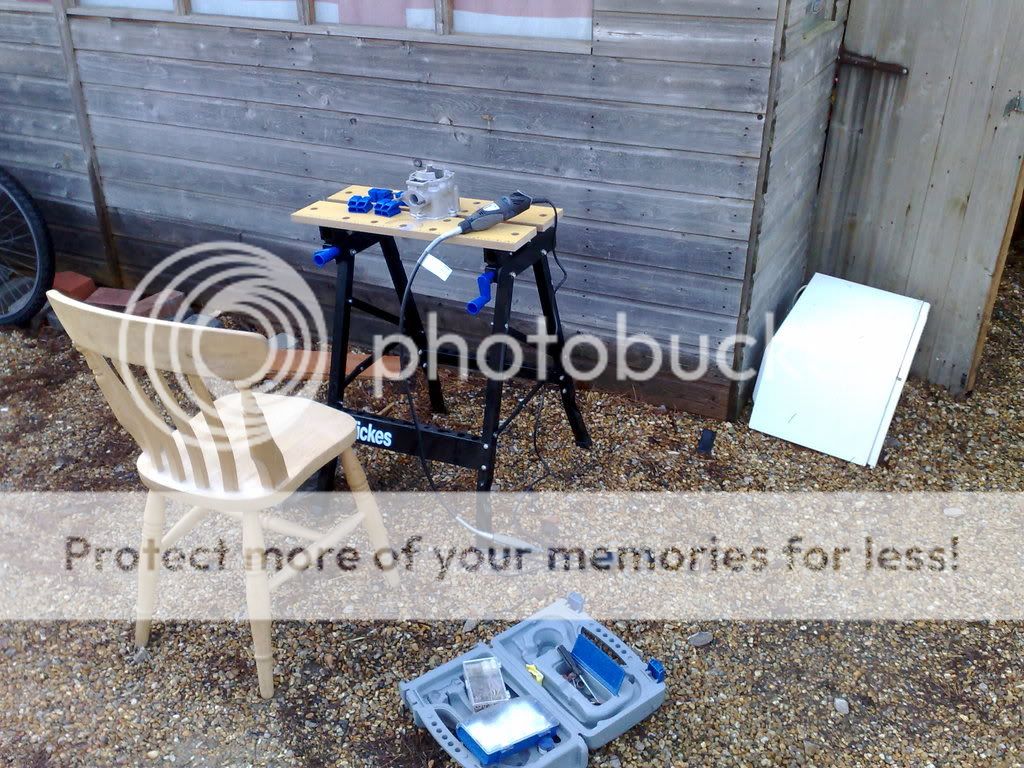

ye thats what ive been doing gamma boi. ye fully thugged out worrkstation. booom. thort ud all love it :w00t:
feed angle is also wrong, its to the right point, but totally wrong direction.. wish id got pics of mine done, couldent see the join
