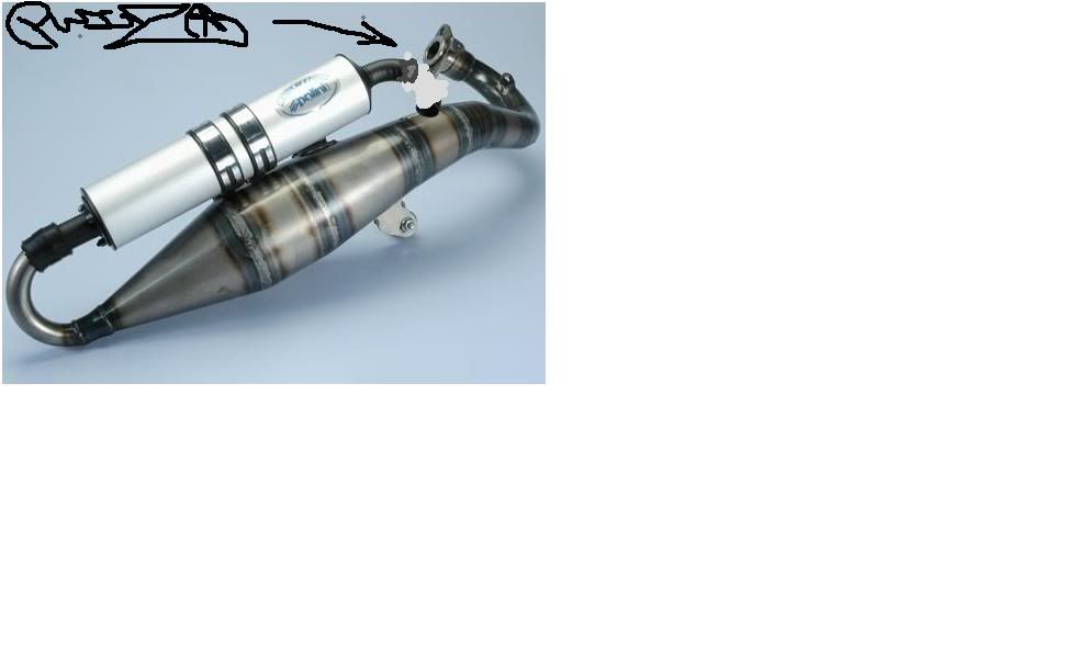

    this is what i want to do to it..
    just shorten that bit on the end, would it work?
  4. MiNoR cOnFuSiOn
    oh that bit... yue can do what you like... its facing backwards for a reason tho. modding this will affect top speed as at high speed air will be forced into the exhaust similar to a ram air system, just in reverse.
