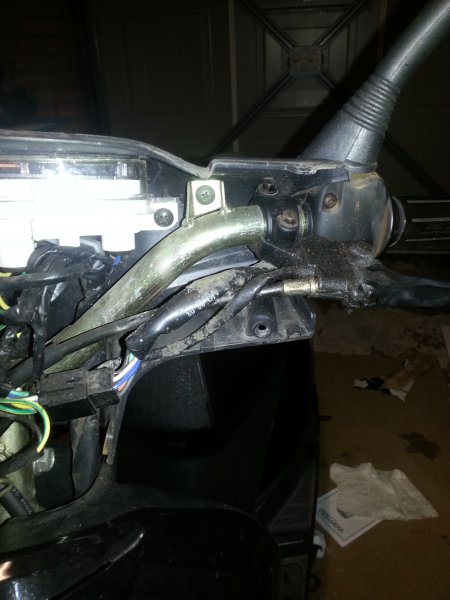

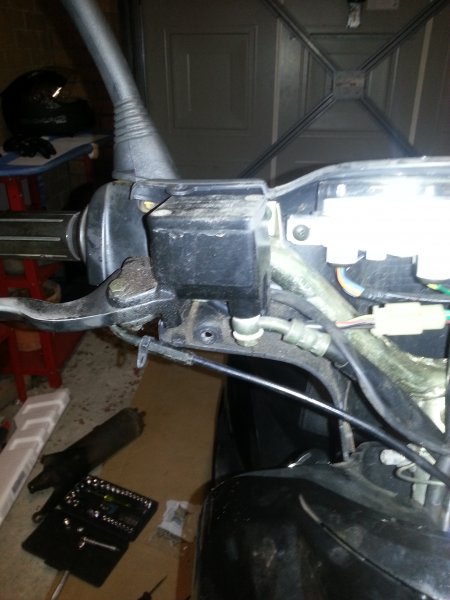

    OK, so everything appears to be plugged in correctly. Pull the left hand brake lever and check that a little plastic pin pops out into the gap left as the lever opens please. Also, turn the ignition on and check to see if the horn works.
    This is an Elyseo brake lever, but it shows where the switch is located.

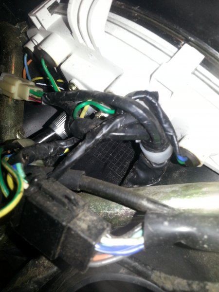

    horn doesnt work, cant see a little grey thing like the one in the pic got some more pics to upload

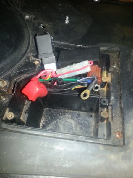

    That's OK Donna, I can see them both in place, just behind the brake cables in your photos. In your second photo above, the first thin black cable next to the lever housing attaches to the switch and that's just behind the cable.
    No horn is a big clue. I bet the fuse has blown. Under the mat that covers the footplate is a cover held on by a screw. Remove the screw and you have access to the battery. On the red cable from the battery will either be a little connector that has a car-type spade fuse plugged into it, or it will have a tubular plastic cover that you have to open to expose the glass fuse.
    Unplug or remove the fuse and check to see if it's blown. If it's a spade type, the wavy bit in the middle will be burned away like this.
    The glass fuse looks like this, except that the wire inside yours may be missing or burned in half.
    If it's burned out, it needs to be replaced. the fuse will be marked with it's rating and replace it with one with the exact same rating.

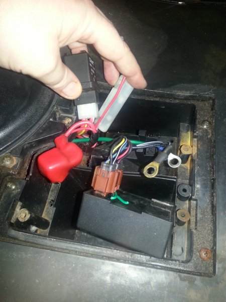

    thanks Merlin, really appreciate your help, ive had a look and i cant find any fuse at all, not the long one that looks like a plug fuse or the one that looks like a car fuse

    Aha! The glass fuse is inside that plastic cover that's between your fingers on the red wire. The cover wraps around the fuse and if you look carefully at it, you can see the metal ends of the fuse inside it.

    got it open, it looks fine but one side of the connection was lose and looked like it wasnt connected properly, but ive lost one of the bolts that hold the wires for the battery down :/ so in the middle of finding it as it fell underneath the plastic battery bay, gonna hook the battery back up and see if it works now

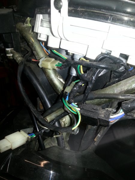

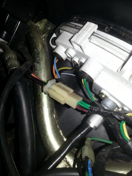

    This sounds like what you have. the only other thing it could be is to check behind your ignition switch, it will have a rubber cover over the wires. Check that they are all attached to the ignition switch terminals, especially the thick red ones that carry 12v from the battery.
    Electricity flows like water, so you have to follow it from the battery, to the ignition switch and check that the red wires going in and out are attached. Power or fuse, it's one or the other.
