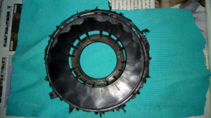

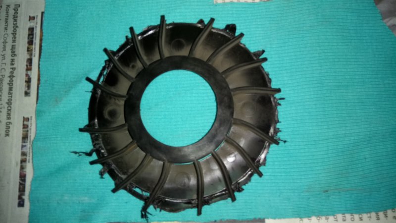

    In the middle of July when I finished my work I started my Zip to go home and on the first corner I hear scary sound coming from my CVT. Immediately shut down the engine and call my father to bring me and the scooter with his car. This was the way to realize that Piaggio Zip can be loaded to Peugeot Partner (just remove mirrors).
    In the garage (with shaking hands) I remove the cover and was expecting complete mess. Luckily (or not) the reason was loosen nut of the variator. The noise was coming from the plastic fan which was touching the cover. That was the result
    I carefully clean the mustaches of the fan and mount it back. This time I decide to use small amount of Loctite 243 for that nut.

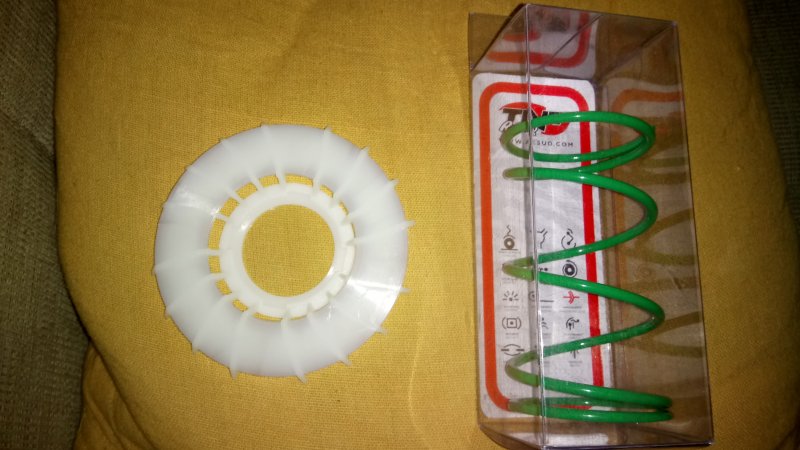

    So after few days I receive this
    But when I tried to unlock Loctited nut I didn’t have any success. The nut was like welded. Absolutely no chance to unlock it. I read that heating will help. What are you thinking?
    About the green spring. I was thinking that Malossi colors are like etalon for stiffness of springs. No! When put this spring the scooter became slow as never before. No speed, no acceleration. That’s why I was in hurry to remove this green thing from my scooter. So and so I will open the CVT cover so I decided to buy piaggio variator tool to try again to unlock that shitty nut. Again no success. Any advice will be helpful for me.
