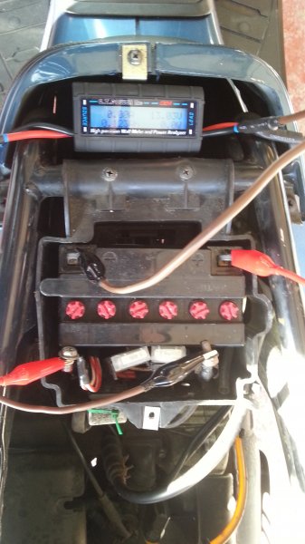

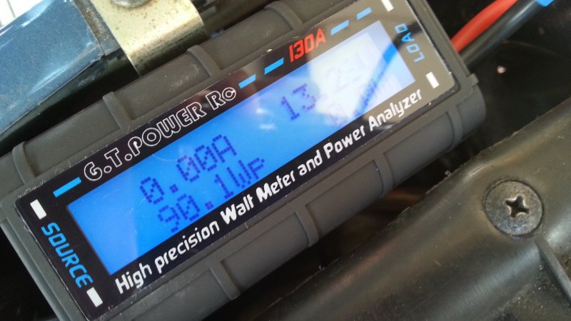

I've recently been running some tests on the electrical system on my Piaggio Hexagon 180 to see how much power the scooters electrics use, how much is spare and how much the stator output is. I tried googling this before but could not find the real world details so did it myself and thought I would share. A they are the same engines the figures should be close to the available stator output on both the Italjet Dragster 180 and Gilera Runner 180 too. Tests were done using a power analyser between the scooter battery and electrical system, this allowed me to test power going both from the battery to the scooter and from the scooter to the battery. Warning: If wanting to do this yourself be sure to use appropriate fuses and connectors as the power use could potentially be quite high. Also on the hexagon the system MUST NOT be run without the battery present, this would cause very high system voltages that would damage the lights and other electrical items...so make sure when using an in-line meter than the connections are GOOD. Note: For tests with lights, I have an LED rear numberplate light that uses 0.3w. I believe the original is 5w so you would need to add or subtract this on to the various figures. So based on my tests it looks like the stator is likely 100w total with a running peak power available of 90w after providing power to run the engine itself. However typically it looks like 25-60w would be available in normal riding conditions. It needs to be noted that the standard electrical system can get into a position where it alone is using more power than the stator can put out, but these conditions are rare during normal riding. Hope this helps people with these scooters, I searched everywhere for these figures and just could not find them so thought I would share. Feel free to repost these figures elsewhere. Oh and here are some pictures of the testing under way:
