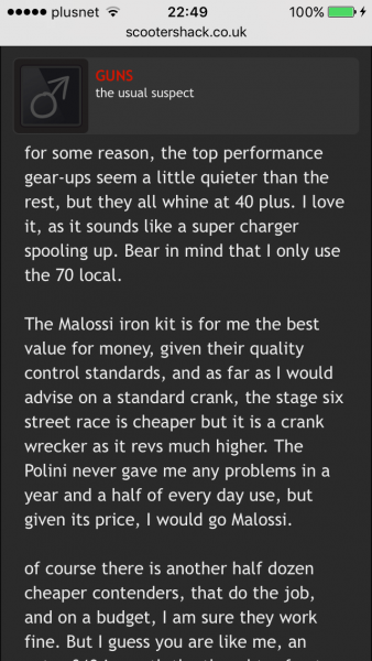

    But then I found this
    Hmmm sounds familiar
  13. Stevep
    Ain't that strange................I just came on to say the same thing about the gear up kits.
    Some of the earlier straight cut malossi gear-ups used to whine, and I was expecting it when I fitted the new kit to my old zip, but it didn't, or didn't as much so I was told.

    Sounds like you may have struck gold there, if the bearings are noisey when you spin them theyre shot should be nice and smooth with no noise dont have to have play in them to be shot. Happy days (hopefully) there mate!

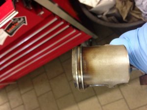

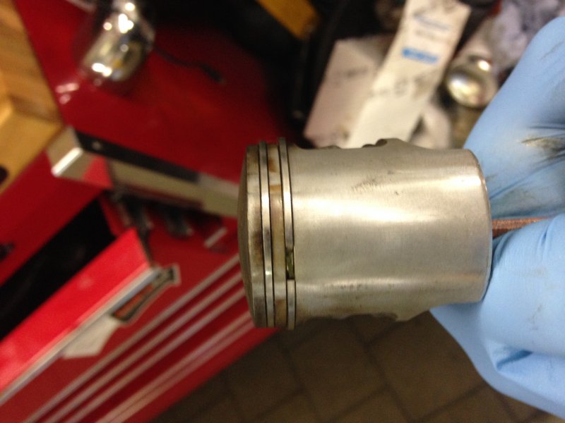

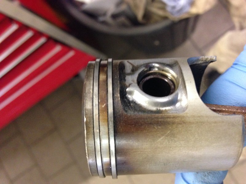

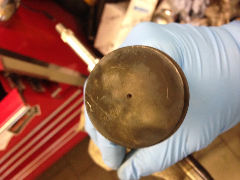

    Not sure what to do about piston or rings
    There looks to be some brown blow past the rings not sure if to change them while I'm in there or if that's normal
    But which means running piston in
    I did think about 70cc kit but that will wreck it then I need to change carb/exhaust
  16. jim231187
    jim231187 Member
    37
    If it were me doing it id order a piston kit from pedparts theyre about a tenner ive had one of theirs before and it was fine, plus then you get a new gudgeon pin too which normally wear. Also id chuck in a new small end bearing. Does the bore look in good shape? (No scoring)

    Looks reasonable from what I can see if it had good compression before hand, I would carefully remove the rings (very easy to break them) and clean all the carbon off especially in the groves where the rings sit then check the gudgeon pin (the tube bit which connects the piston to the conrod) for any wear and check the crank for any up and down movement in the big end bearing side to side movement is ok. As its all in bits you might as well go over everything ;) whats the bore like? (bit inside cylinder where the piston goes up and down in) should be no score marks.

    Yes bore is fine no noticeable score marks was thinking of new rings would you stay with old ones or get new?
    No play in crank and conrod not had time to gudgeon pin yet will at dinner

    37
    Because a standard piston kit is so cheap if you want to do the rings just change the piston and gudgeon pin aswell theres not much price difference between rings & piston kit. If I were rebuilding on a bike I was using daily I would replace while its all stripped down.
