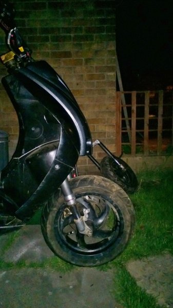

    been a loooooooong time since ive even looked at the Ludix since i bought a Runner, but i thought ill have a play with it tonight. No pics till tomorrow, but ive managed to fit (bodge) a set of Runner forks on with big disk brake, runner wheel, and new brembo caliper, it looks shaweeeeeet!:p Ive also got an evo mudguard for the runner forks but i cant make my mind up if i want it on or not -.-
    To get the runner forks on i had to make a shim. Cos the steerer tube on runner forks are longer, the threaded headset locking rings are further up. So i just cut out a piece of tubing from my old BMX frame (snapped due to being pro;)) Then tightened the locking rings, used a BMX stem and they work perfect!

    only pic i managed to get, was took at 1 in morning so sorry for quality and darkness haha

    yeah its been a while since ive even touched the Ludix, its been abandoned in the back of my shed, but i got bored earlier and ive got loads of spare runner parts so i though ill try grafting some parts onto the ludix?
