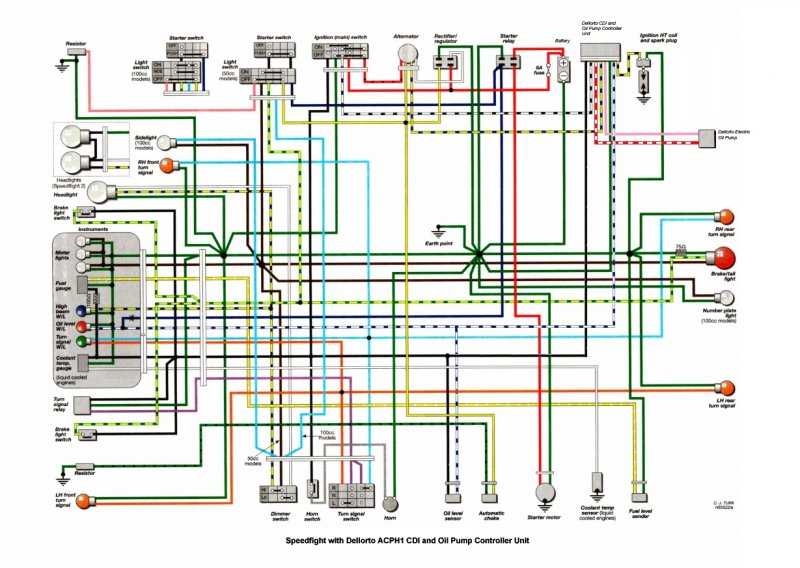

    Would like to know if the conversion wiring harness to change peugeot speedfight from simple cdi with oil pump controller unit to APHC1, is available in the UK. Alternatively the plug socket (8pin) that will connect to the APHC1 unit together with wiring diagram, for conversion.
    There is a combined complete conversion on the internet from Europe but at very high prices.
    Thanks for advise

    I made this wiring diagram some time back, so show the electronic pump wiring. For some reason, Haynes missed this out.
