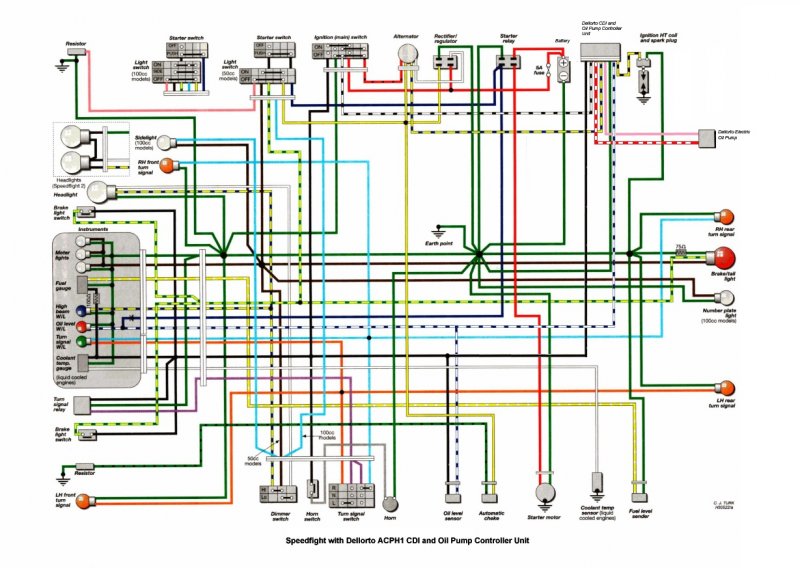

Tried both methods a few more times but no luck. If I start the bike up with the carb input pipe off the pump, it squirts one drop of oil out but then nothing after that first drop? Maybe dodgy wiring? Nothing that I can see though
My bike has the Dellorto system and the pump is the same as the Speedfight 2 (Dellorto ACPH1). On my bike, I disconnect the oil pump wires from the oil pump, then I disconnect the oil pump feed pipe from the carb. I turn the ignition on then plug the oil pump in. It starts to pump every five seconds or so for a minute or two, then changes to every two seconds for the last minute or so as it bleeds the pump. I don't have to touch the throttle at all. I've edited a Peugeot wiring diagram, to show how the Dellorto oil system wires into the loom and connects to the CDI. The pulse from the pickup of the stator goes through the Dellorto unit then on to the CDI,where it triggers the spark. This is how the unit knows how fast the engine is running and how much oil to dose. For some reason, Haynes missed this part out of the fuel/oil system when they updated the workshop manual. The only other thing I can think of is to check the battery voltage, as the Dellorto unit does have some self-diagnostics inside and if the 12v feed has dropped too low, it might trigger the flashing bulb as a warning. The rectified AC voltage would exceed the battery voltage and may cause the bulb to flash. The bulb turns off originally as the 12v AC rectified output from the stator feeds a diode in the clocks that back-voltages the 12v feed from the starter relay and oil level switch, thus cancelling it out, making the voltage go to zero and making the bulb go out when the engine is running. Adding 1% oil to the fuel is a smart move as Peugeots have always run a tad lean on oil, I've always added 1% as a precaution. If you want to run on premix all the time and forget the oil pump, then 4% is what you should be aiming for (25:1)
Thanks everyone! Oil problem sorted. The red and white wire was almost completely disconnected from the pin that goes into the connector! Not visible from the outside of it but when I popped the cable out it was clear that was the problem. Anyone have any ideas of what the rattling sound could be though? Not a big problem but does my head in when riding. It seems to be in the head by the sounds of it but can't be too sure.
