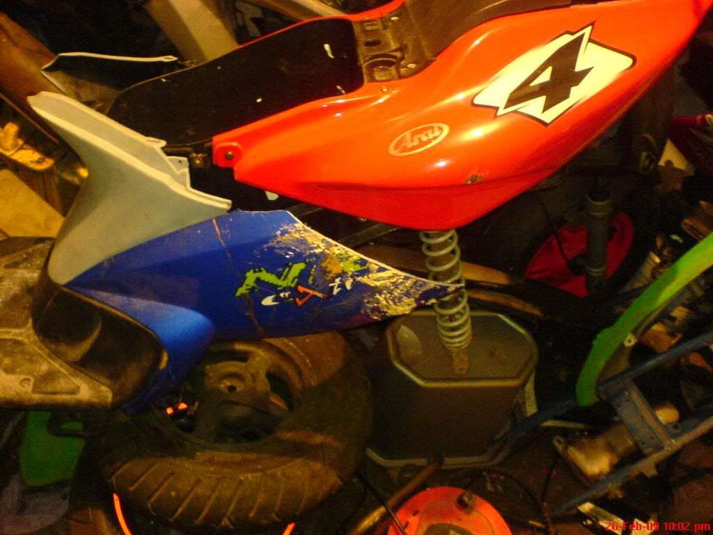

    aint started cutting yet im gonna try my spare drag rear on it and see which i prefer. areox rear lines up well only a cut here and there some drilling and spacers.
    Will proberbly knock sumat up got rox nrg and typh bits i could use but i do like the look of the frame
    the fuel tank i will use a areox one they fill up just at the back but ill have to find a different way of attaching it also might have a secondary tank under seat but i still aint decided what this bikes gonna be a road or race bike or both.
    oh and a bit of a update no pics atm but got myself a dragster rad but im going to try use a nrg bottle and hoses also got a drag wireing loom and bars and clocks hmm anyone gues what type of engines off in it lol

    i would personally fibreglass the rear panels into one and cover the petrol filler hole up and just have a decent size underseat tank
  3. MiNoR cOnFuSiOn
    id go diff.... id be laying the inner pannel on, then the new rear over the top, mark the line where they crossover and then cut it leaving an inch to sit behind the new pannel... will be a pain to fit/remove but if you use an nrg one it retains the plug inspection pannel... also the nrg side clip ins should marry up really nicely to the rox rear... meaning a seamless pannel swap... MIGHT be able to mod the seat bucket to take the entire rear inner pannel, i doubt it tbho, wouldent know without looking. what you dont want is one big pannel you have REAL trouble fitting like all the runners that get glassed up... some you literally have to slip the frame into like a pair of trousers then build around that :confused: point?

    finish it lol that would be nice i keep on haveing crazey idea's one is getting a custom frame made but i realy need to stop thinking that
  6. nrgandy
    rightio had a little play recently
    also the side will look simaler to this need some nrg pans tho

    making the nrg pan smaller but then making it so it clips into the clips on the rox panel it will be hard to get right so will take loads of care cutting measureing etc
