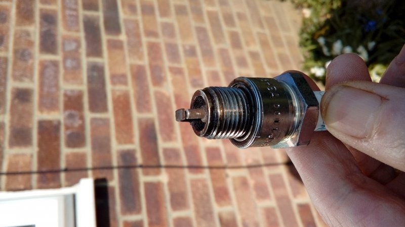

pull your plug out and have a look ....... compare it to the plug i attached here ( that plug is a nice chocolate brown thats what a good burning mix should look like ) take of side panel where oil tub is, check the pipes are sealed on tight make sure they dont have any cracks. wipe the pipes off top up oil tub and leave it a few hours, see if any seepage has happened on the pipe leading to autolube, you will be able to see it when the pipes are nice and fresh wiped and clean. i mentioned early on in post about bike shops ......... theres a chap called Gary in cawston that owns GB motorcycles , if you have a chance pop the bike down to him he a very good chap has a lotta spares and a huge knowledge of bikes n scooters he will check your nrg and tell you straight up whats wrong . just tell him Paul with the sym jet sent you ( i get all my parts from him he a great chap and will help a fellow biker when he can )
