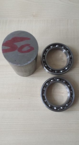

  7. mrhappy
    mrhappy Member
    177
    It's welded and pressed in to crank web
    Pic of new crank bearings we run now

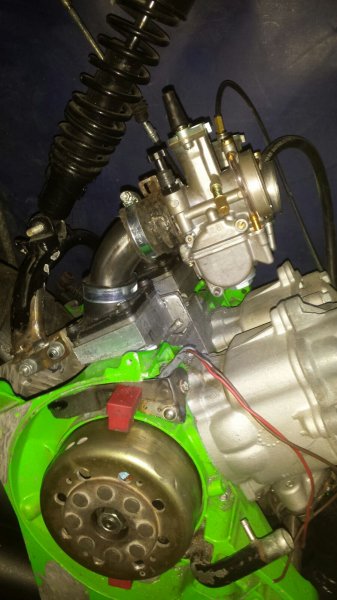

  8. MARSH
    MARSH Whooooo!
    3,266
    Piaggio Typhoon
    Are you running 2 ignition coils on the stator plate?
  9. MARSH
    MARSH Whooooo!
    3,266
    Piaggio Typhoon
    I got the twin back from PSN scooters today, they've had it for a few weeks to give it a shake down (damn good thrashing). Anyway Andy set the carbs up, transmission etc and it's still in one piece (crank joint etc) so can't be bad! Running 20.8 hp but on std carbs so pretty pleased. I'll need to fit a new drive belt /clutch as it tops out just over 60mph, getting there slowly. :)

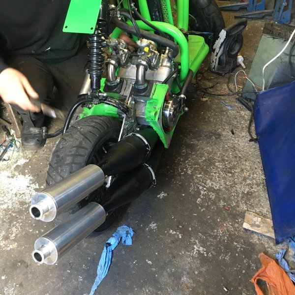

  13. seancullen
    seancullen Member
    127
    et4 125,px80,dna50
    With regards to running a 2-1 expansion chamber, I dont think it can be possible, I briefly studied expansion chambers as part of my acoustics module this year for presentation idea's. when a 2t engine fires, it sends out a positive wave of pressure, when this wave gets into the chamber it expands, upon reaching the end of the chamber this wave will bounce back in the opposite direction (thus becoming negative pressure), at the same time the motor will be scavenging, which helps this negative pressure get sucked backwards towards the engine, taking with it some unburnt fuel back into the cylinder.
    If we had a single expansion chamber serving each cylinder then i could only imagine that the positive wave of pressure from cylinder 2 will intefere with the returning negative wave from cylinder one when they collide with each other, usually in physics, when identical positive and negative pressure waves collide they will simply cancel each other out and there will be no wave left at all, which could well happen in this case.
    2-1 systems do exist for 2t motors as mentioned in an earlier post, but I dont think they would be expansion chamber exhausts.
    edit: http://advrider.com/index.php?threads/multicylinder-2-stroke-into-one-expansion-chamber.758526/ ive just come accross this thread on my travels, so it does infact work, how it performs though i cannot say.
    ReverendSkipper and BunnyMum like this.
  14. Stevep
    twin pipes will be better, what about a quad pipe? 1 into 2 each side? should maintain the back pressure i think
