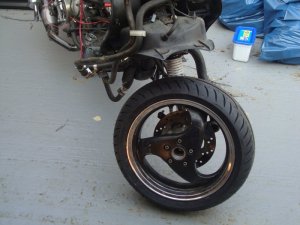

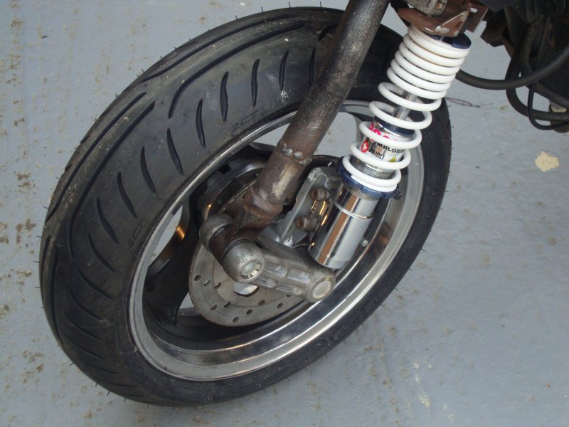

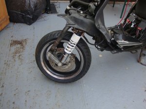

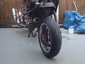

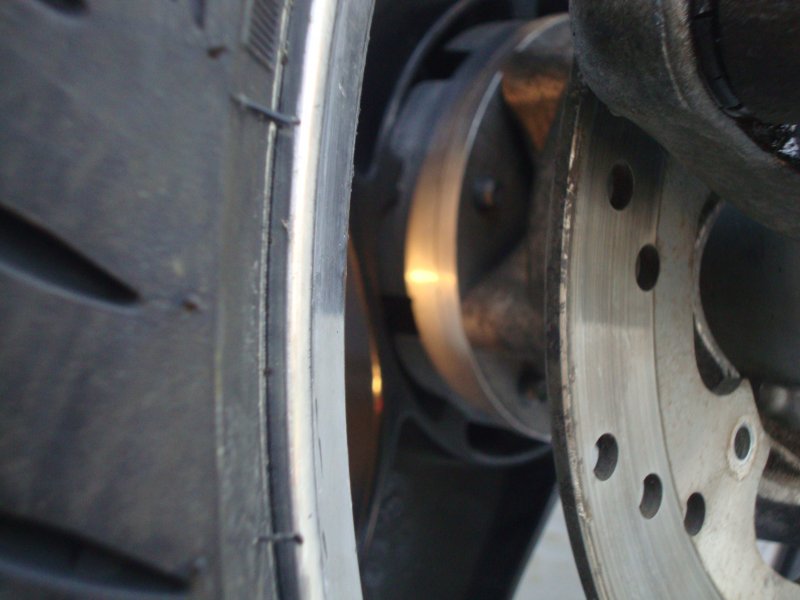

    A little update on the twin, new front end just about finished. 2015-03-22 04.46.50.jpg 2015-03-22 04.47.12.jpg 2015-03-22 05.18.38.jpg 2015-03-22 04.48.20.jpg 2015-03-22 05.23.40.jpg GT 125 forks cut n shut a little to fit. Last photo is of the spacer made for the offset of the NRG wheel. I'm still dry building at the moment, still haven't rode it yet!
  12. scubabiker
    i cant stand those vespa forks, well just vespas in general, they just feel a bit, dunno... errr thin? its like they want to turn all the time, but they dont...i guess if you use one daily you get used to it.
    what made you decide to use that front end and not conventional forks?
    just for the looks?
    i love this project!
  13. MARSH
    MARSH Whooooo!
    3,266
    Piaggio Typhoon
    I don't know really, just to be a bit different I suppose, the original forks are crap as you know so thought I'd do something else for a change, should be a lot easier to set the Malossi shock to suit weight of the NRG? We'll see how it rides soon enough!
