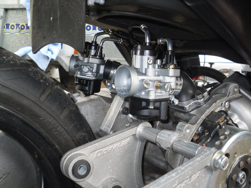

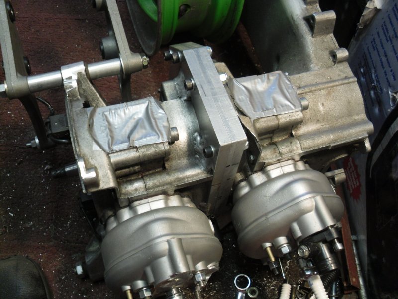

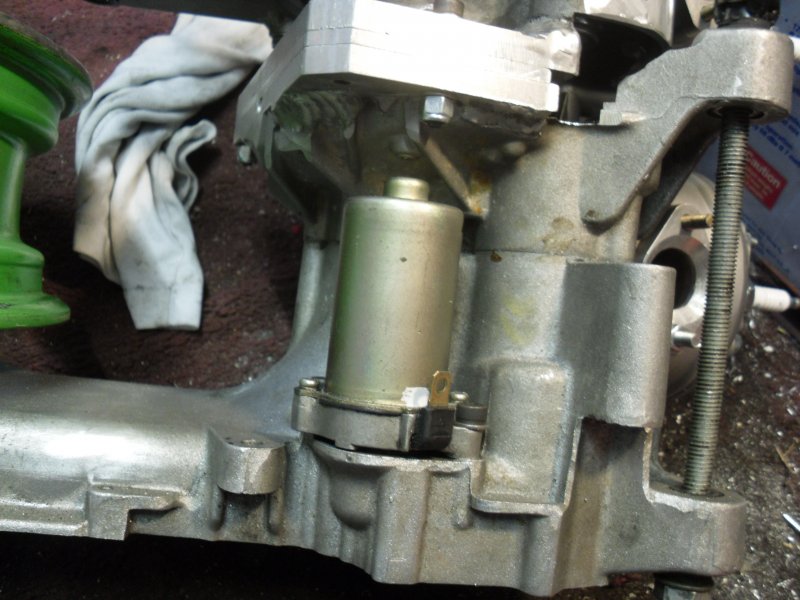

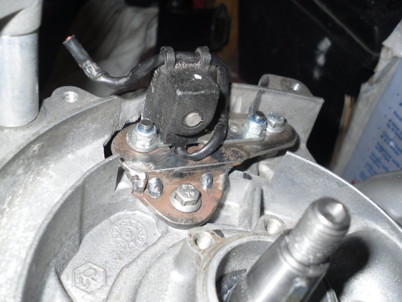

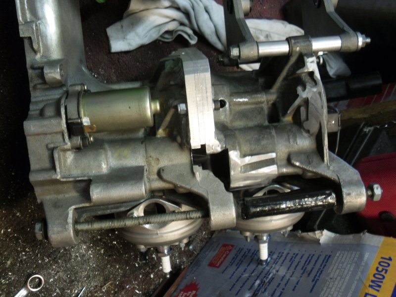

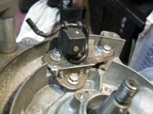

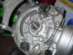

    SDC10726.JPG SDC10727.JPG View attachment 8423 SDC10731.JPG SDC10732.JPG SDC10736.JPG SDC10734.JPG SDC10733.JPG Just a little update on the twin, the second pick-up now mounted/timed and built up. Waiting on reed blocks n manifolds then I'll make a inlet manifold to run a single carb to start with. 80cc starter motor. Getting there slowly!

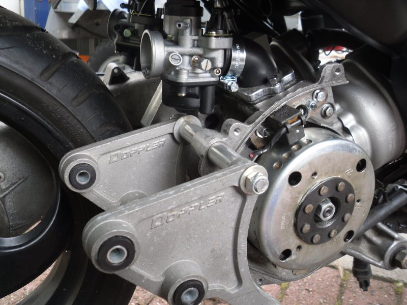

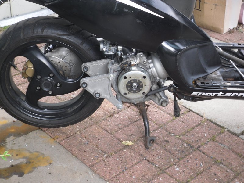

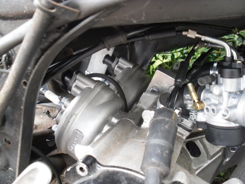

    A little update for those that are interested in my slow moving project! SDC10765.JPG SDC10766.JPG SDC10768.JPG SDC10775.JPG SDC10771.JPG SDC10770.JPG I might actually get it running soon!

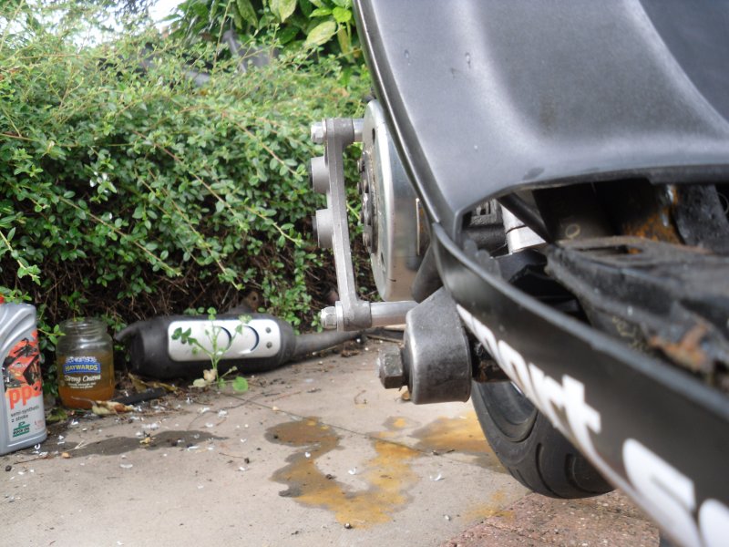

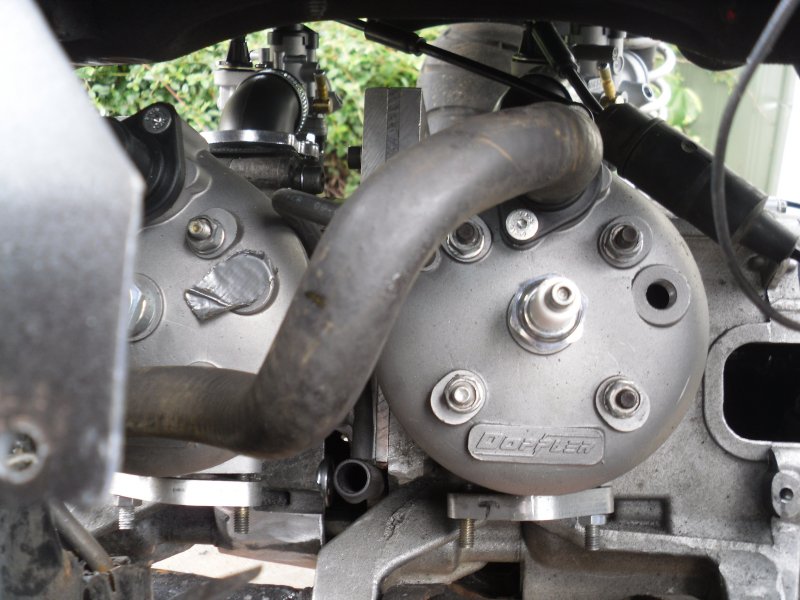

    nice, the way the exhausts are reminds me a bit of the tz750, with exhausts pointing out where ever there was room! have you ridden it yet? how does the balance feel with the cylinder being offset from the wheel like that? i guess its not really noticable
  20. MARSH
    MARSH Whooooo!
    3,266
    Piaggio Typhoon
    I'll re-make the pipes so they are stacked like a formula 125 but just using as is while I'm testing the engine. If it all goes tit shaped again I can just sell the pipes as they'll bolt straight on a std scoot. As for the weight it's no problem, my old 250 twin was heavy and also moved over to the left of the frame but I had to use a wheel spacer, this engine sit's in the original position, you'd hardly feel any difference riding it.
