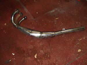

  16. scubabiker
    here you go, thats for a gt380 or 550 triple. i think it was allspeed that made them i could be wrong tho. ive seen them for twins too

    scubabiker,,,both bikes you mention have 3 exhausts for each cylinder,,,,,,i think the exhaust in your picture must of been abit of an experiment,,not sure how it could work because the expansion chamber is way to small,its the same size as one of the standard chambers
    interesting to see though,,,would be good to see it fitted to a bike and running,,still cant imagine how all three cylinders could pump into one exhaust
    i mentioned the italjet formula 125 a few posts back,,,,,this twin cylinder scooter has two exhausts as standard,,,,,you can also buy a performance endy exhaust for it,,again this is a twin exhaust
  18. scubabiker
    thats an aftermarket exhaust, micron to be exact, they made them for the twins and tripples, maybe gibson/allspeed made them too. i believe gibson are still making pipes

    right chaps this is what ive found,,,,,a 3-1 2stroke exhaust will never outperform an expansion chamber for each cylinder because of the pulses hitting eachother inside the pipe
    a 2-1 2stroke exhaust will give good results when setup to the crank but still wont perform better than a chamber for each cylinder
    setup right these pipes are good for saving weight and producing a noise like no other,,,,but again there experiments that dont fit well with the 2 stroke design
    these words have come from someone who builds exhausts just like the ones posted above
    just watched a few vids of these,,,,,they sound like screaming banshees,,,very nice
    and supposedly there used on snowmobiles all the time,,,something to do with the crank degree,,not sure
