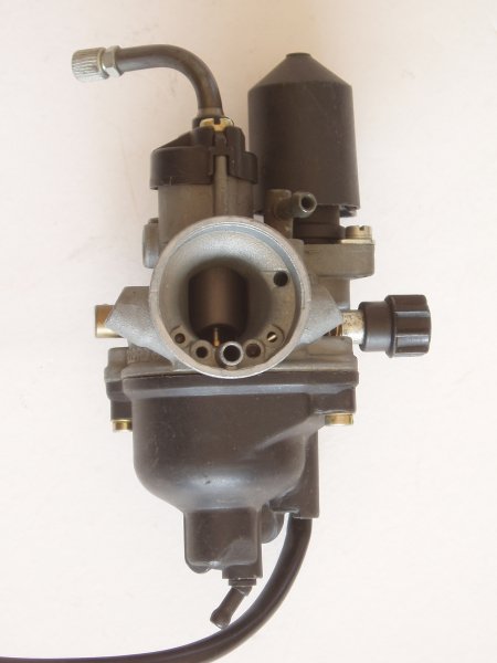

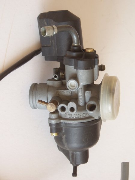

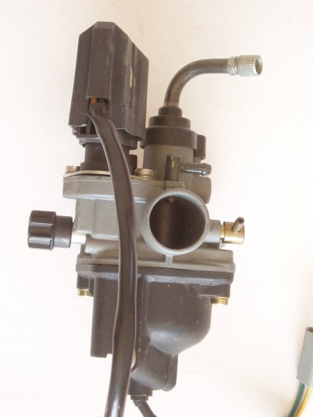

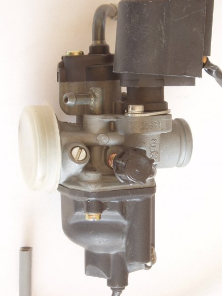

Isn't that one opposite handed for the adjustment screws on your machine, or can the screws be reversed to the other side? They would certainly be on the wrong side for my Peugeot.
Yes, it is on the opposite side from the factory fit carb, but even so, that was not easy to get to either, the problem I have with this carb is that petrol pours out of the overflow hole in the bottom,
Hi check floats/needle valve. If the floats are holed and sunk or there is crud in the needle valve seat - that would do it -
