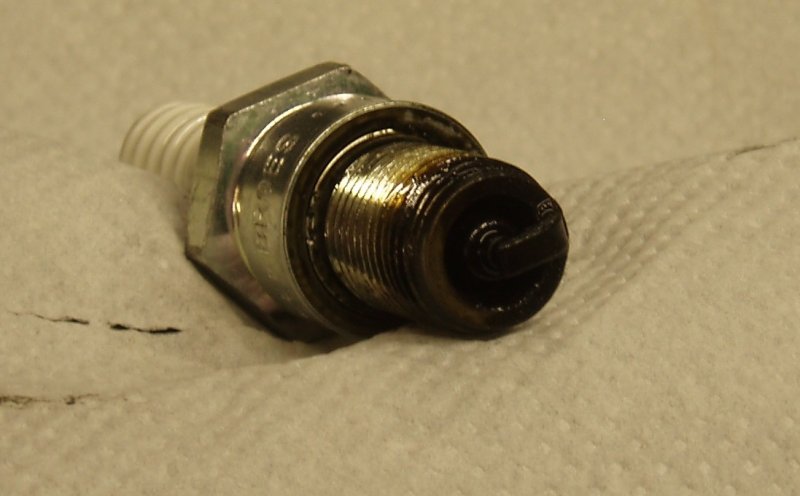

unless... the only other thing that would do it would be an ignition problem. coil on the way out or duff spark plug......
I have changed the standard pilot jet from 45 to 38 I changed the standard main jet from 90 to a 70 the spark plug is new, last week
the only thing I know that makes a wet plug other than a very rich carb is a dodgy ignition. Can you try another coil?

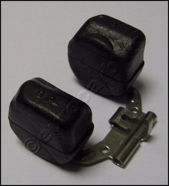

one thing I did notice on one occasion last night, after I changed the float setting I started the engine and then it cut out, and petrol started squirting out of the side vent elbows, is this a clue to the problem or is the carb just too big?
That indicates to me that you went the wrong way with the tab on the floats and the needle valve was opened more, not closed more. The bowl fills up too fast and then overflows. Try going the other way with the tab.
Just to be clear on what you call "the tab" on the float, is it the cut out two sided prong, in the middle, or the upright bit to the right, if it is the two sided prong in the middle, would you want to see a bigger or smaller gap between "it", and the main metal body
