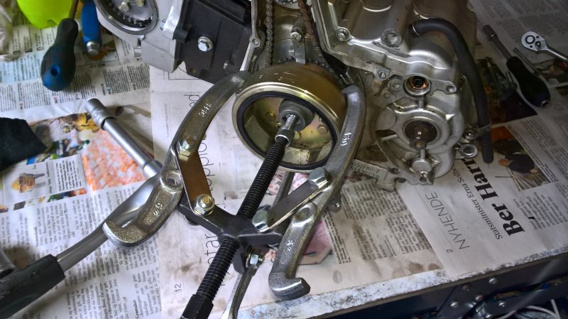

    thats how to set up a grabby puller tool, theres 2 types (screw in ones and grabbers)
