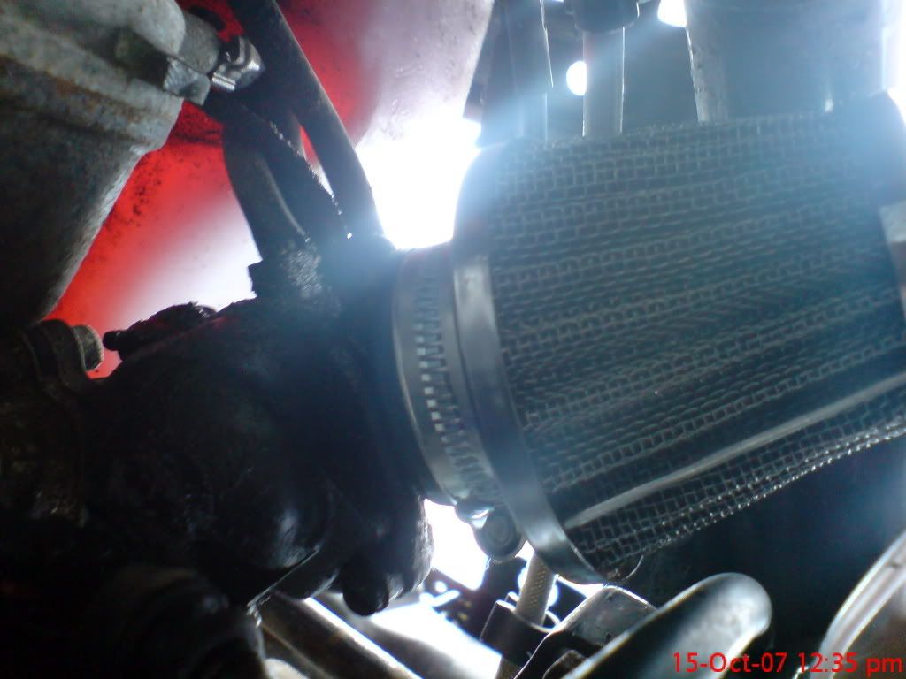

  8. Jamie
    thats bogging out big time
  9. fuj_yammy54
    fuj_yammy54 New Member
    334
    it was. i put some foam inside the filter, so its not bogging now.
  10. haugh
    haugh New Member
    1,688
    your meant to upjet not put foam inside the air filter :confused:arc:
  11. fuj_yammy54
    334
    waitin 4 my jets 2 be delivered by royal mail. filter came first so i fixed it on. got a #86 in at the moment, gonna put a #92 or 94 in.
  12. frainey
    frainey New Member
    1,041
    Just been on the bike accel is faster aswell as the good old k&n sound,
    Its being upjetted wednesday by me and fuj :w00t:
  13. fuj_yammy54
    334
    if i put a #100 jet in, would it run faster or not?
    my setup is :- Leo vince TT pipe
    KandN air filter
    Manual choke
    Does 55mph at the moment, would it increase top speed???
    thanks, fuj.

    u need to jet it properly for ur setup
    the bigger the jet dont mean the faster it will go lol

    would it stop bogging down??
  16. wobbly_trials
    lean the bike off to get quicker, chocolate brown plug is your optimum anything lighter and you'll melt a hole in the piston

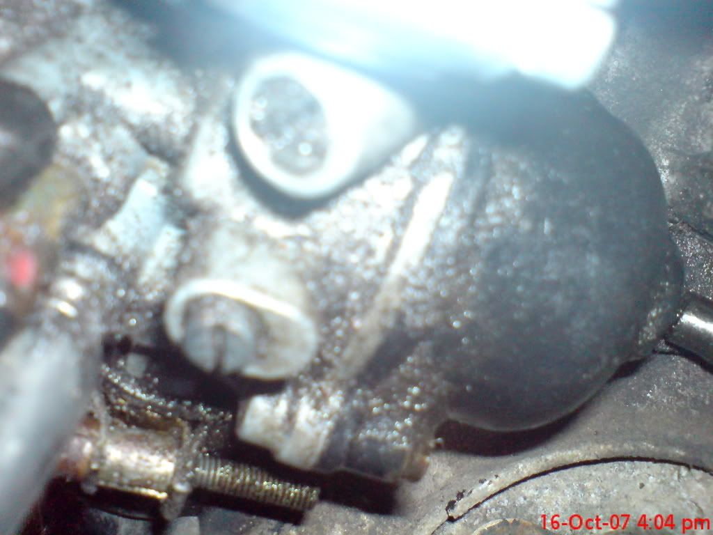

    Cam someone please tell me which needle is for petrol/oil mixture?
  20. Sw1fT
    Sw1fT Active Member
    2,940
    200SX S13
    right one
