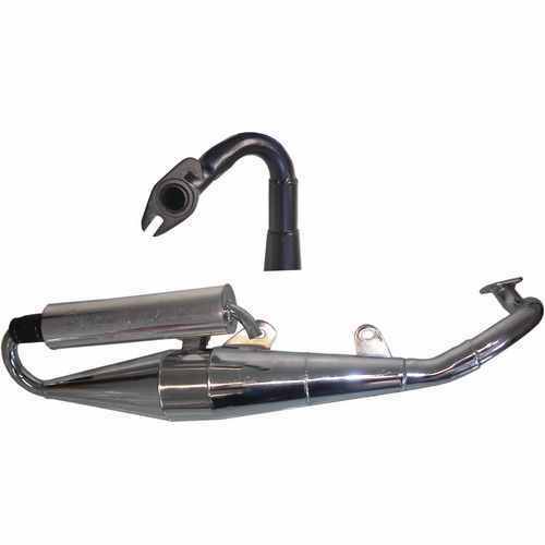

@markymark2 its got 5.5g rollers its got a 90 main jet i think maybe 95 seemed a bit high but its running better than it did its still got the blue steel washer in the variator as far as the exhaust i got a leo vince didn't fit so i got this one el cheapo (see pic) the first one fits just so then i come across this one thought yeah for a cheap one again was told by the guy on ebay this will definitely fit 1 and a half inch from the head ...waste of another £90 on ebay so in stuck with the one in first pic they are apparently both derestricted pipes
good for you , they are a surprisingly good pipe , not mega cool looking or loud ,a good thing , just make sure that there is no washer spot welded in the manifold of the pipe , just look into it and if hole is smaller than inner diameter of pipe then it`s got the restrictor washer in it , 2 minutes with a Dremel and job done. Most pipes are restricted this way so they pass the "E" mark rules , never assume a pipe is sold fully derestricted no matter what the seller says as most are full of shit and just want your money, mgood luck.
