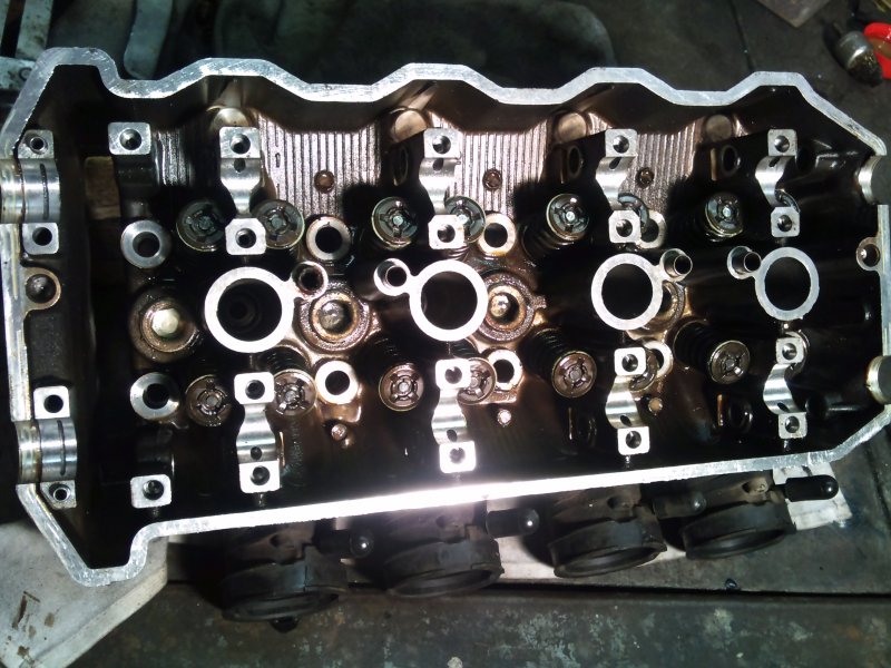

    i did a head a few months back with really narrow seals like that, i thought the seats where fucked, but it was just like that, think it was a dragstar 125, but cant really remember
  2. Stevep
    Hence the use of a big magnifying glass;), difficult to see if it's a nice even ring all round without it. But they're done now, all nice and even and no pits on either of the faces.
    Been a while since I've had to do something like this on any bike, I think the last one i did was my old goldwing.

  8. Stevep
    All valves in, little colletts are a pig, thank god for grease and a little flat bladed screwdriver DSC_0364.jpg

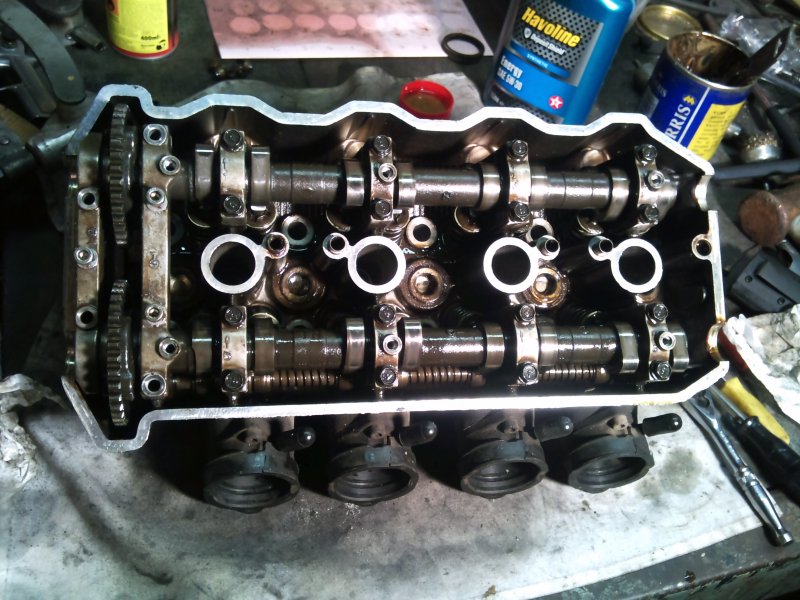

  9. Stevep
    rockers in, cams in, torqued down, time to do the pallet shims
    scootzmadness likes this.

  12. Stevep
    fcuk fcuk fcuk fcuk:mad:
    pallet shims are way too big, and i haven't got any thinner ones left.
    only a couple of thou' but cant run this engine tight.
    Bastard!
    Dead stop!!!

  14. Stevep
    More shims ordered. 2.35/2.40/2.45mm
    They're not going to land before the weekend but nothing i can do about that.
    And before anybody says anything................yes I know i could build it up and put the head back on the bike and do all that stuff, but it's much easier to do it on the bench as it is now.
    That way if I drop a shim, it's got no chance of dropping into the block requiring an engine out and strip to retrieve it. Which I don't think it can thinking about it, seeing as the cam chain is on the side and not in the middle.

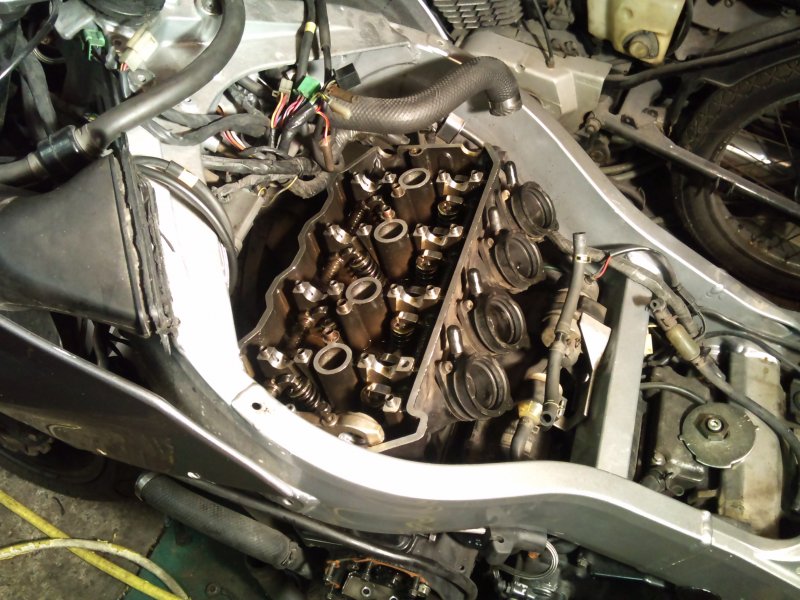

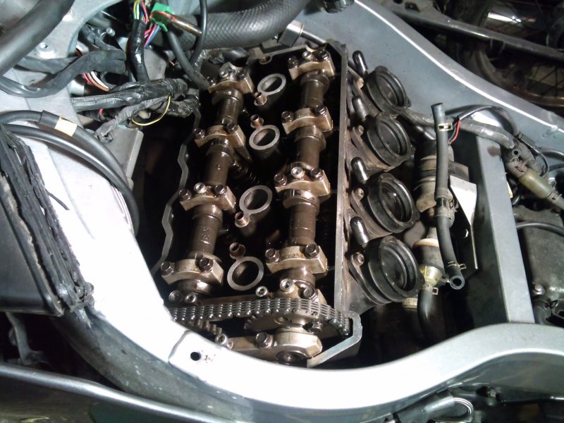

  19. Stevep
    So I worked through the night,
    1: because i had a runner to do,
    2: because i'm at work sunday night and dont want to screw up my sleep pattern
    3: because i can get on with my "stuff"
    Valve shims are all done now, head back on bike, all torqued up to spec, cams back in, new front and rear cam slippers, new cam chain, all timed up, well oiled (wish i was) and moving freely.
    Only managed a couple of hours on it because of doing the runner, but it's just a case of putting all the ancillary stuff back on now.
    So close yet so far

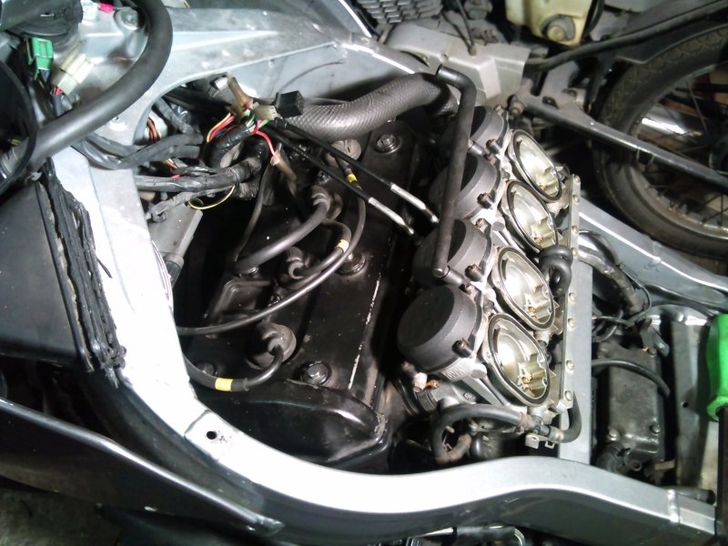

    Getting there.
    Cover on, broke a bolt, found a replacement, carbs on, fuel and water lines fitted to carbs, throttle cables on, plugs in, leads on (all the right way round) DSC_0368.jpg
