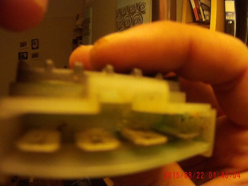

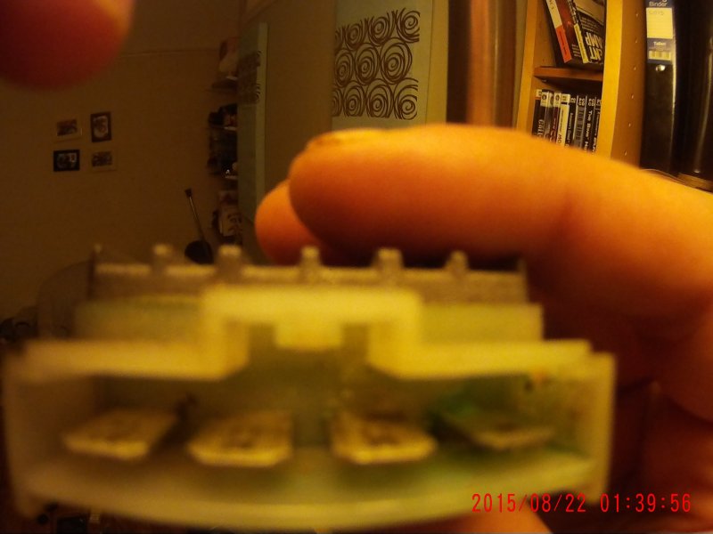

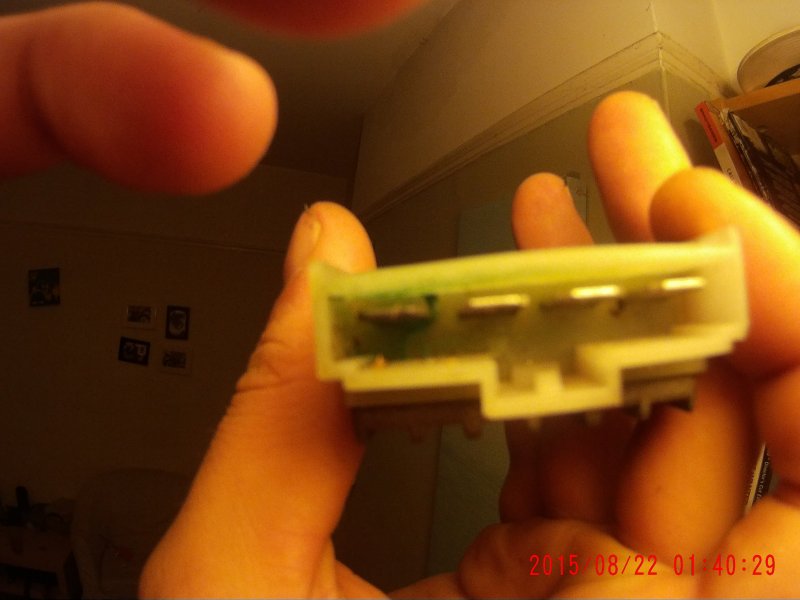

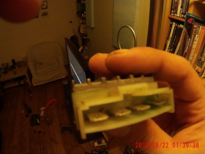

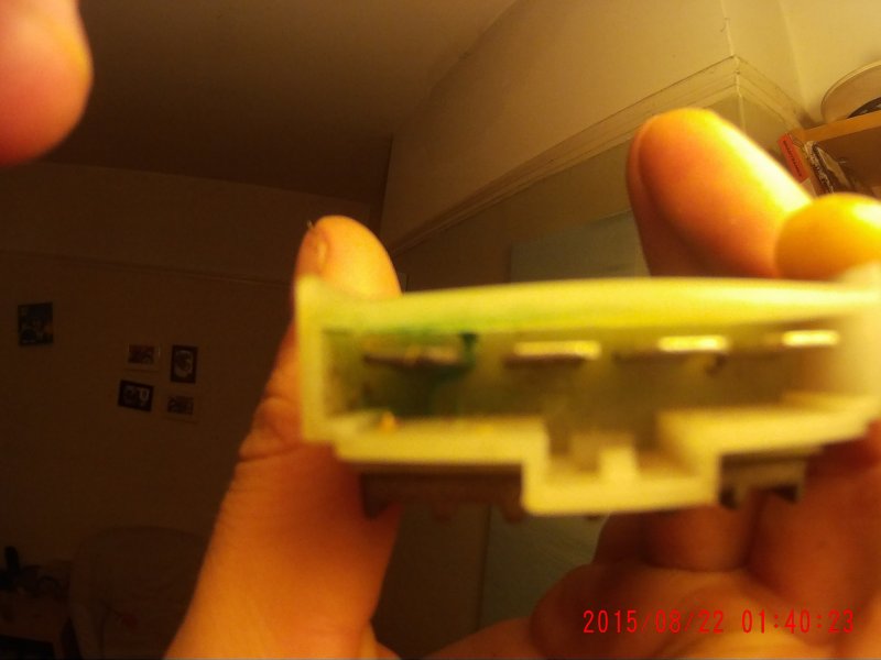

    Recently just to add to fustration my electrics havent given up the ghost aswell all the lights work its just when i rev the engine the lights go very dim and brake like dosent work,thought i'd take a look at the regulator/rectifier and found this.It seems to have corroded a bit like an old battery think this could be the problem?Anyone had same thing happen??

    Simple enough to whip the pins out both sides of the connector block and either clean or replace them. Or replace the block completely with a weatherproof one.
