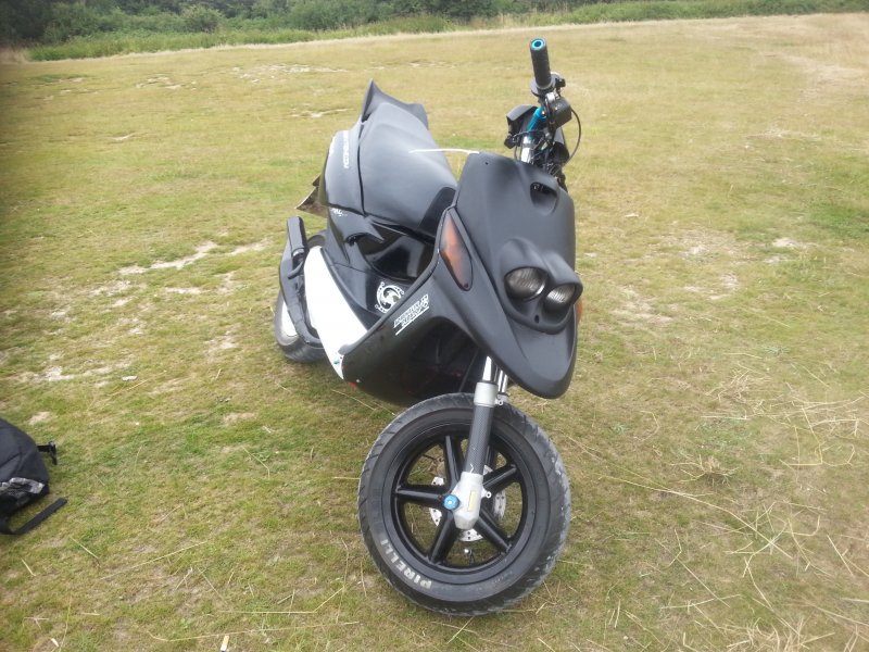

    Here is some 2 year old pic of my Rocket, today shes back the same, going 70km/h, not more, otherwise the cops can confiscate the bike and wreck it...
    Also here compared to my former 2012 pic you can see that there are not cracks in the leather of the seat, whats the best way to repair it instead of buying a new one ? I think a rocket seat original might be hard to find and costing tons...

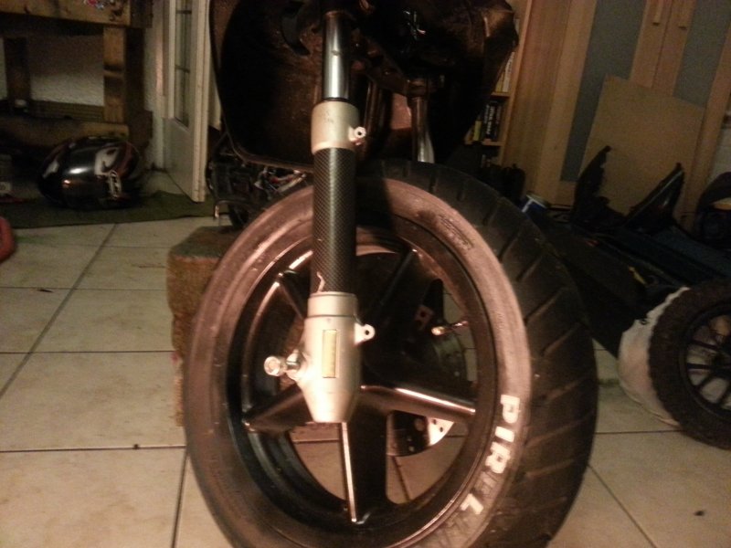

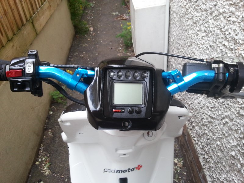

    Picture of the koso clock and surround. Only slight problem is it means i have to have handlebars at a 45 degree angle away from me to see it when im driving.

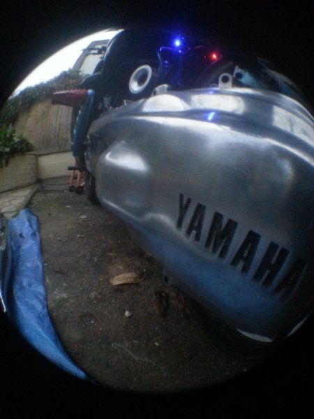

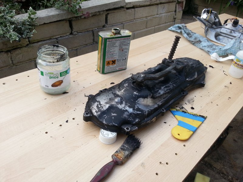

    Polishing my crankcase for mbk rocket
    Started work on polishing a spare side case i had from a yamaha bws engine.... 20130625_191234.jpg

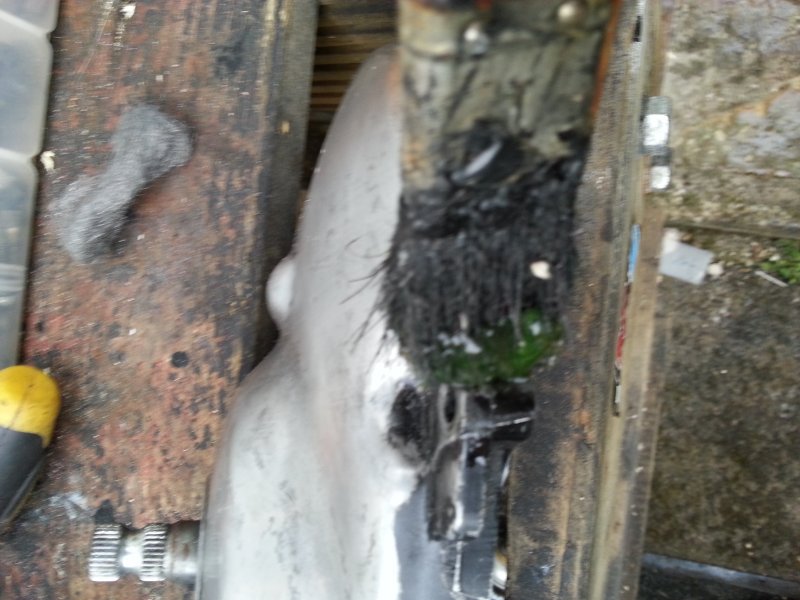

    Using nitromors and wire wool to get the paint off,Plus the wire wool helps to buff it up a bit 20130627_185933.jpg
    After a few hours i'd managed to get this,Plus my mate helped out 20130627_185745.jpg

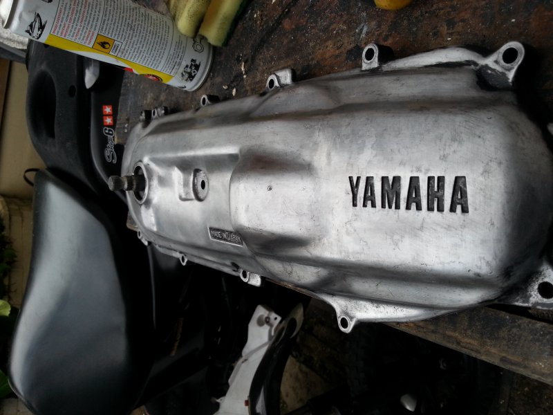

  14. bikerbeynard
    bikerbeynard Luke
    164
    gpr 125 ,mbk rocket,
    now fitting the thing was very different caused me a lot of trouble because when i put it on bike the kick start would always catch on the variator,pulley and not allow the kickstart to fully return.I was starting to get very angry and eventually gave up........
    Until today my dad came and gave some advice /had a look and we realised that inside the case there to pieces of metal that held the kickstart in place were to long and therefore the case wouldn't sit on properly, So i got the angle grinder away and ground them down bye about 2-3mm. Resulting in the crank case sitting flush on the engine....
    So a word to the wise a yamaha bws/spy crankcase does nbot always fit an mbk booster or rocket (minarelli vertical) you may have to do some fine tuning like me
    This is what she looks like now

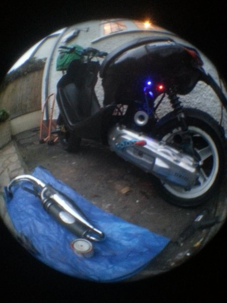

    Got my ZX today throughthe post, so i am now upgrading from leo vince tt to leo vince zx and it willl be interesting to seee the difference.
    Only cost me £15.00 plus £10.00 postage off ebay,BARGAIN

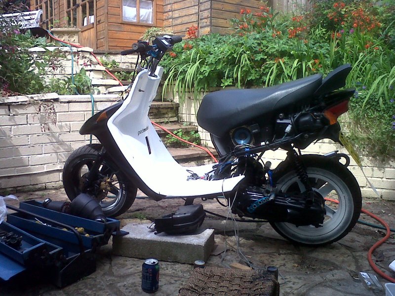

    So i thought the 21mm carb was eating a bit to much fuel plus i coudn't get my bike to have that low end power so that i could pop wheelies and maybe it was just trying suck in too much air.So i thought i bye myself a new 17.5mm carb with original airbox,because last time it had wheelie power that was the setup.
