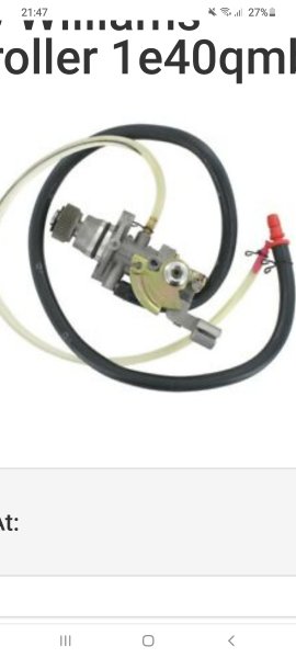

    have you got a cable already to your old pump ?
    The first photo pump does not have a cable as it relies on the revs to put more oil in the engine.
    So your pump looks like the first photo ??

    I ordered the first pump thinking thats what I needed , but turns out I need the one with the cable as there is a cable that needs to go to it, at the moment it only has half of the pump inside, the missing part is for the little cable that needs to attach to it , i can't find it anywhere

    Thanks for the photo and see from that that there is a pump with cable to it
    By that photo your scoot has a 1E49QMB type engine.
    I would not try to swap over part of the pump to go on the other pump, and the first photo does not have a shaft to be long enough to fit, and if it did manage to fit you would have 2 pumps in one pump.
    Will they not take back the pump back so you can get the right one.

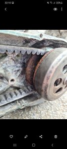

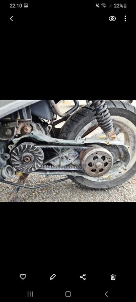

    Thanks mate, i think that is exactly what I need, I've also got to replace all the transmission , i will screenshot my images i took today, until I removed the trans case I didn't know why it wouldn't turn over , ill upload in a second you will be shocked

    The state of it all

    I'm also going to need to replace the starter motor but shouldn't be too hard , will need long Allen keys for it , when i looked at the state of it I was like this is why it dont turn over, they did a number on it , luckily I only paid £80

    Yes shocked, what a mess
    Does the engine turn over once you remove the belt
    On the belt there is a number like 669 18 30, but your need your number and they should be able to help with belt as well,as you said all needs new parts

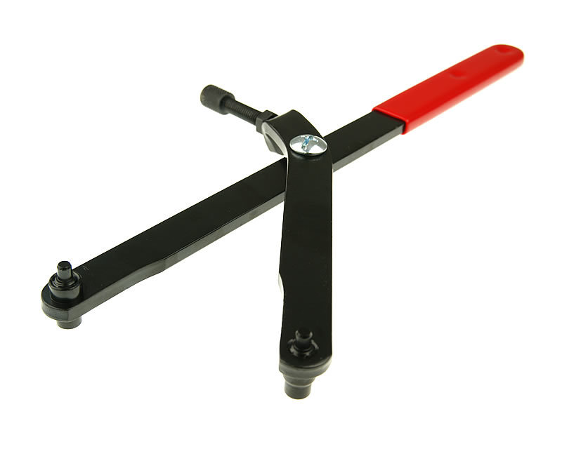

    Your need a tool to hold the variator and the clutch
    variator tool
    https://www.ebay.co.uk/itm/Keeway-F...238810&hash=item463c9eea7a:g:h4oAAOSwuq9ZYUoQ
    clutch holding tool
    https://www.ebay.co.uk/itm/Scooter-...01252899172?epid=25016994555&hash=item5d6c895
    Also should have new clutch and variator + belt

    I managed to get the variator off no problem, but the clutch and everything behind it impossible, need stronger tools , will have to have a look

    As said managed to get variator off , but the clutch keeps spinning so can't get it off , will need a tool i think
