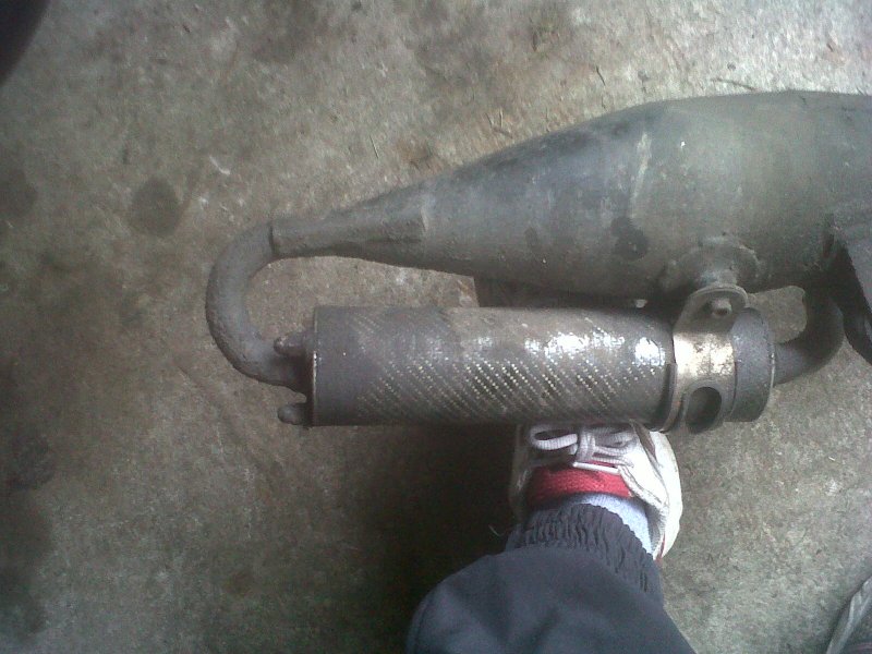

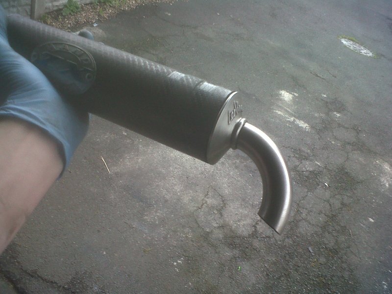

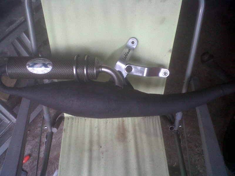

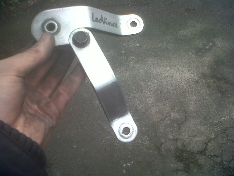

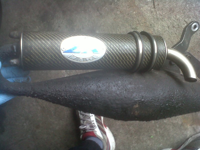

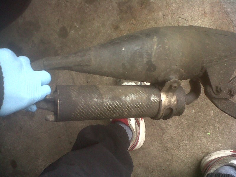

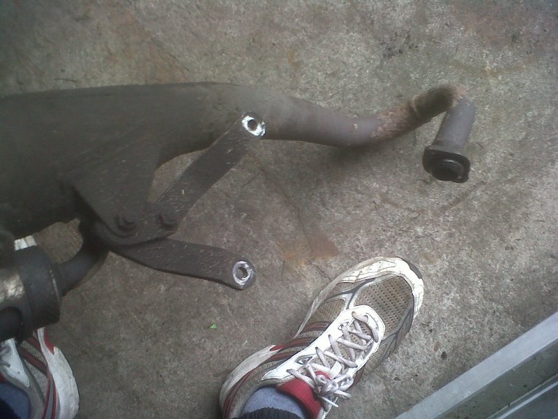

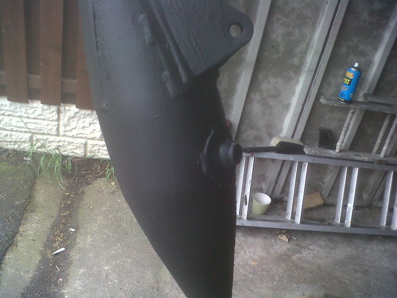

Just a little guide people say how do i get rid of rust ect or clean my exhaust and all this stuff well im gunna put up a quick guide of best ways to clean it. This is how the exhaust was when i got it I first decided to strip it down and clean every single bit of the exhaust. After realising the main exhaust pipe was fucked and been painted and bubbled as been put on shit i decided to sand down and respray but fort im gunna clean endcan and bracket really well so here is a few pics below. The best way to clean it is too wipe the surface down with water and then get a grade 400 sandpaper and scrub away and it brings a nice shine to the surface take a look at the bracket in the pics (before and after pictures) Once you get the surface like that it takes alot of hard work to keep it that way give it a wipe down every now and again Let me know what you guys think
Nope the bracket takes along time to rust but thats why wen gets dirty give it quick wipe down, ive got gianelli extra chrome exhaust and had it nearly a year and not got one spec of rust cause i take care of it, i wipe with wd40 every know and again
that looks smart mate, did you use wet and dry paper for the bracket, and are the leo vince brackets all like that underneath the paint layers?
use wet and dry and you'll be still doing it next year, get some 400 grit sandpaper and get it till chrome starts to come through then use wet and dry to finish it off
basically... degrease, clean off rust with wire brush in electric drill, paint using high temp paint. Wrapping can in carbon vinyl. gently warm vinyl with hair dryer or hot air gun. Wrap around making sure theres no air bubbles DONE
