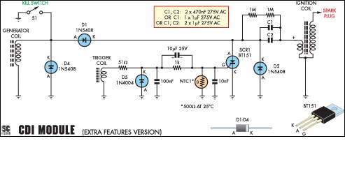

  10. donic
    donic New Member
    18
    With a bit of electronics skill it's possible to build a replacement CDI module very cheaply.
    I assembled this one from a kit and it works fine with AC stock stator on Air-cooled Piaggio 150 2T.
    In my experience it has been perfectly reliable for more than 3 years now.
    It's not my design, nor am I selling them. Just thought I would mention it since it's a chance to save some money on your AC ignition should the factory CDI unit stop working and you are looking for a replacement.
    I have not tested it with an LC stator however I suspect that it will work OK.
    You could probably also use this with a 50cc stator as well, but you will need to have an ignition coil pack similar to the sort you get in a sport kit.
