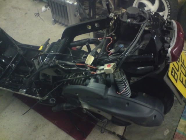

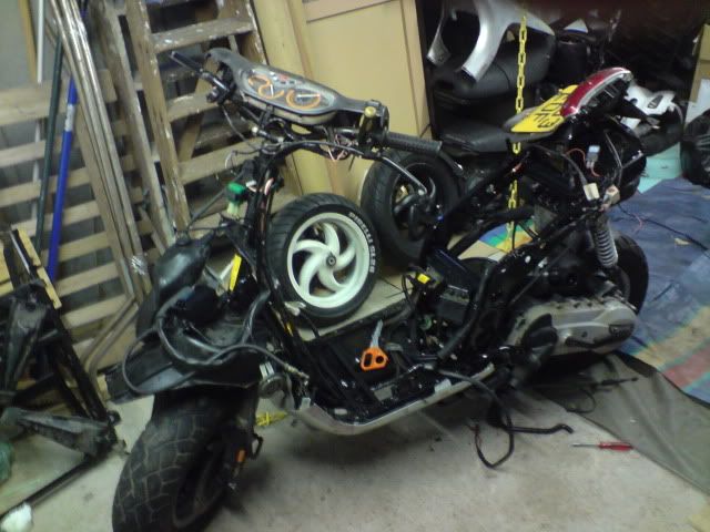

    RARSE! ent updated this for shit lol, well moved along way from fitting the engine together :lol:

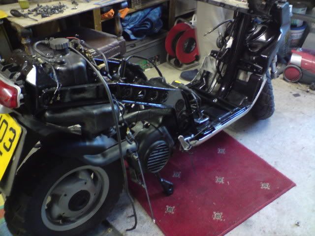

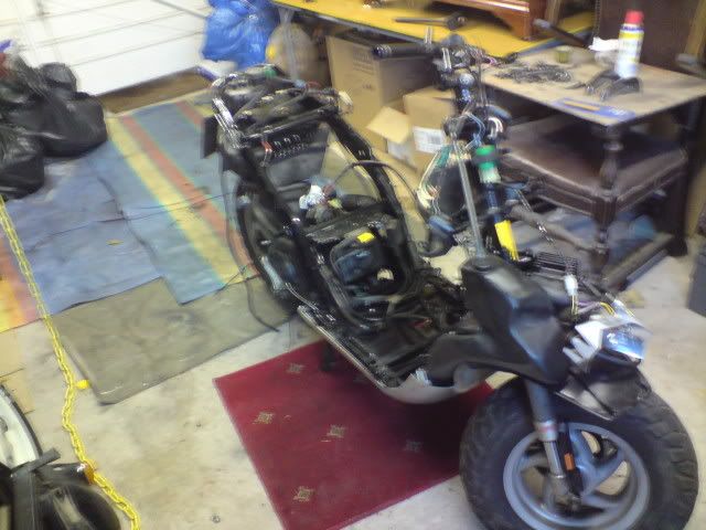

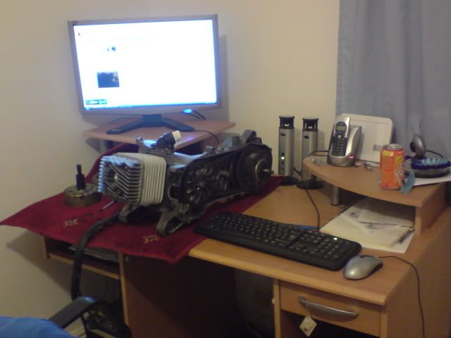

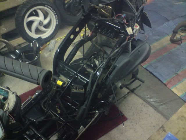

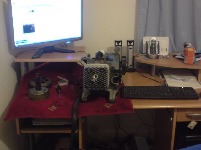

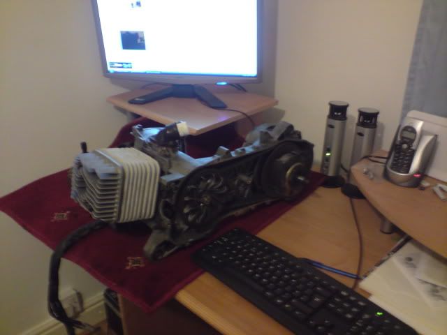

    ok erm, got the engine together fine all good :) (in my room)
    then it got banged into the typh, with new exhaust fresh rear wheel and shock :)
    Started it up for about 10mins at low revs then done the procedure for runing it in
    the next day it wouldent start and i tried 3 carbs 21mm 20.5 28mm
    none of them had any luck so i checked the cylinder to see if it was ok, it was fine thank god, i now think its excess 2T in the cases but cant flush it out without a kick start/elecy :(
    pics of how it is standing now
    just need a new kick start mechanism that works and ill try agen, and update you guys soon ;)
