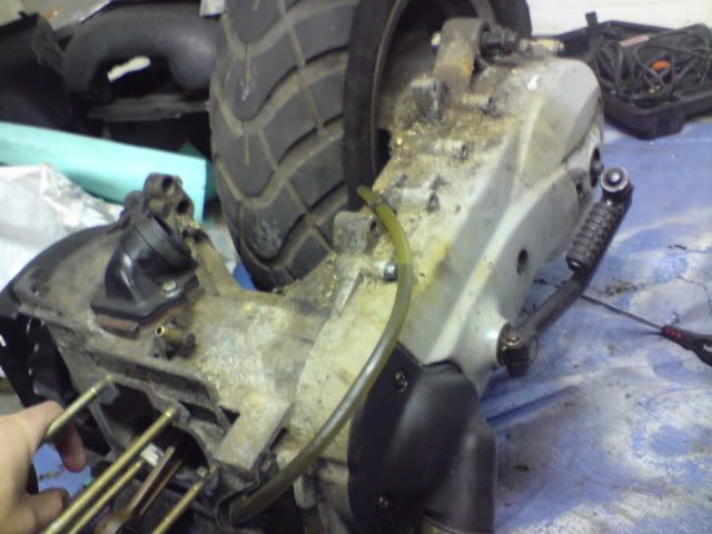

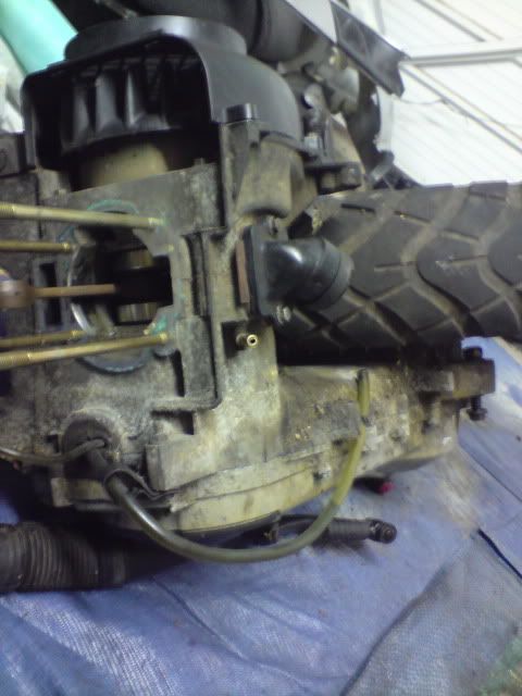

    Update,,,, me and my dad have been working on it today and weve snapped the airbox off and some other stupidly seized shit that has corroded into the engine cases lol
    now im stuck (done a search btw) just need to find out the foloowing sizes :beg:

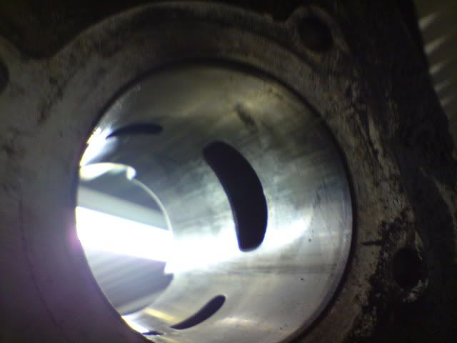

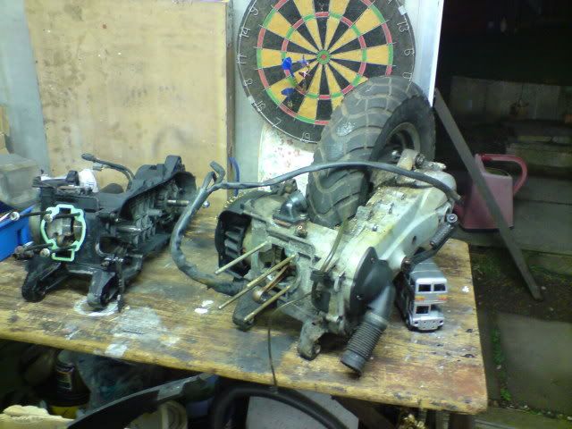

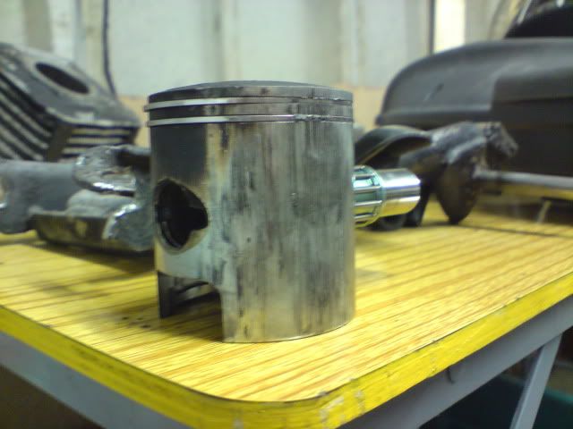

    Right, hers some old pics of the engine before i cleaned it, as my phone ran out of memory now :( (lc 125 runner engine next to it)
    old barrel and piston, the bearings are also rough

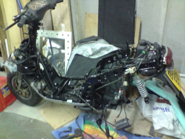

    heres how she stands with a new rear shock and bush kit :)
    Updates as soon as i get my tools :whistle:
