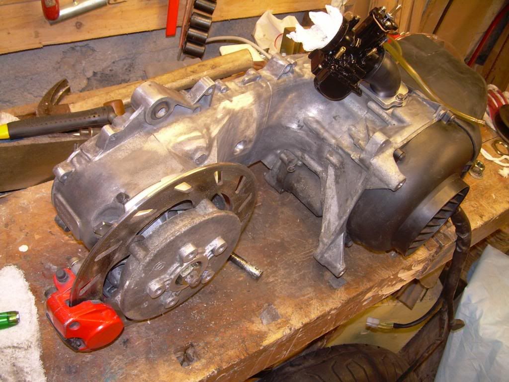

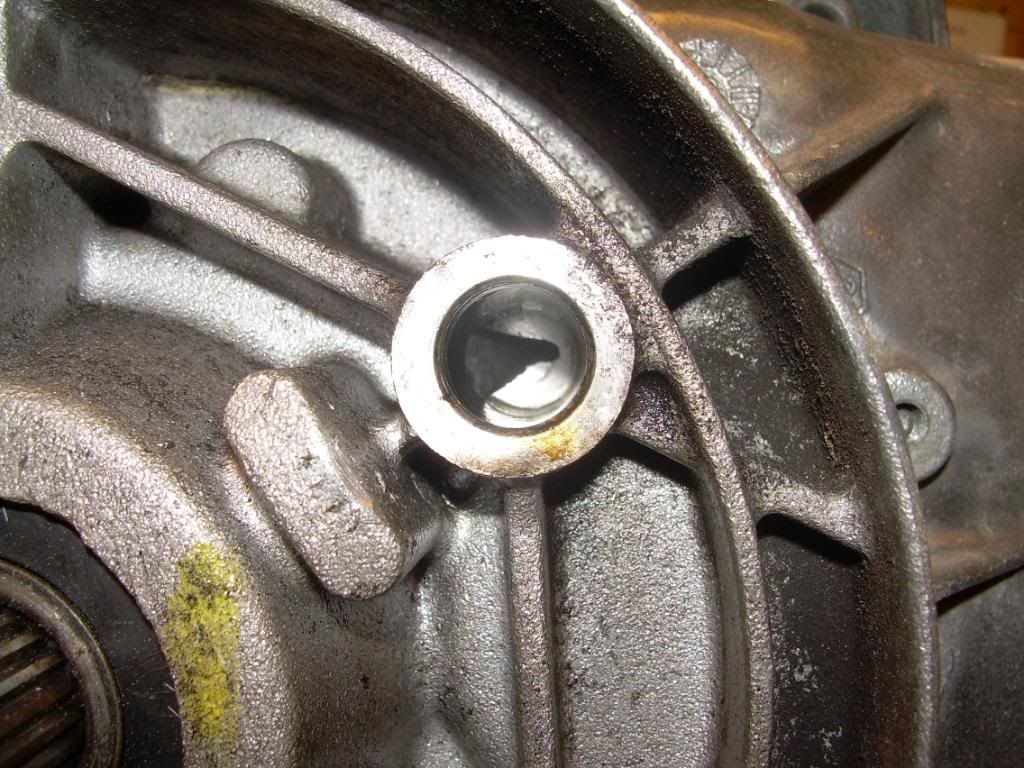

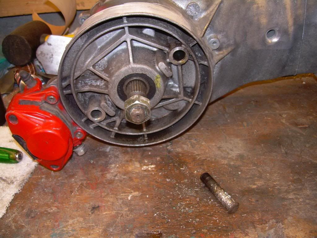

    Today I got the brake bolt out, but to my surprise it's a hole inside that goes straigth in the gearbox???
    I did plug it up with some "glue".
    Here is the engine converted to diskbrake :D

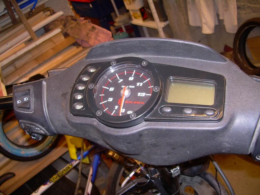

    Just a preview of the Runner speedo in the NRG housing.

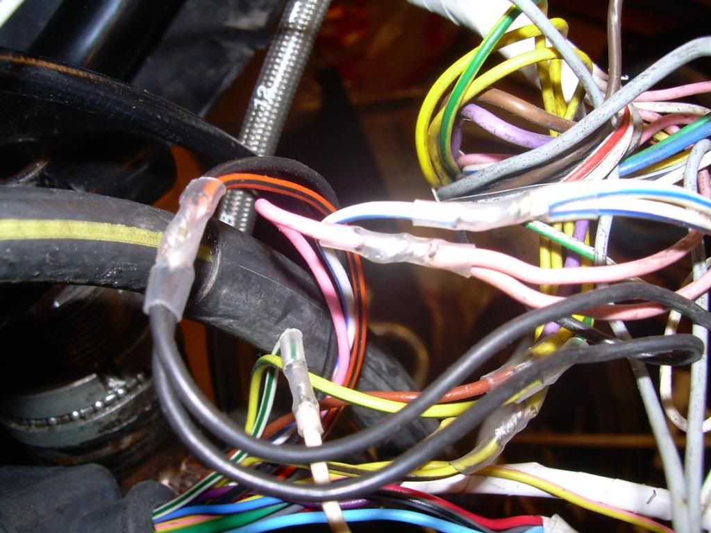

    Close up over the wiring work.

  11. Jefr0-180
    Re: My Typhoon project 172
    Very nice mate, how did you get it out? Can you not just grind it off then?

  13. italjohn
    italjohn Member
    531
    To get it out, I use heat and ice. Yes i could just grind it off, but I like to have the opportunity to reinstall it.

  15. Jefr0-180
    Fair enough, did not even know it came out to be honest. For the swap to disk I'm guessing you just need to take that out, get a hub and disk, rear brake caliper, change the LH brake resevoir area if you get me?
  16. italjohn
    italjohn Member
    531
    "Fair enough, did not even know it came out to be honest. For the swap to disk I'm guessing you just need to take that out, get a hub and disk, rear brake caliper, change the LH brake resevoir area if you get me?"
    Yepp thats about it :pimp:
