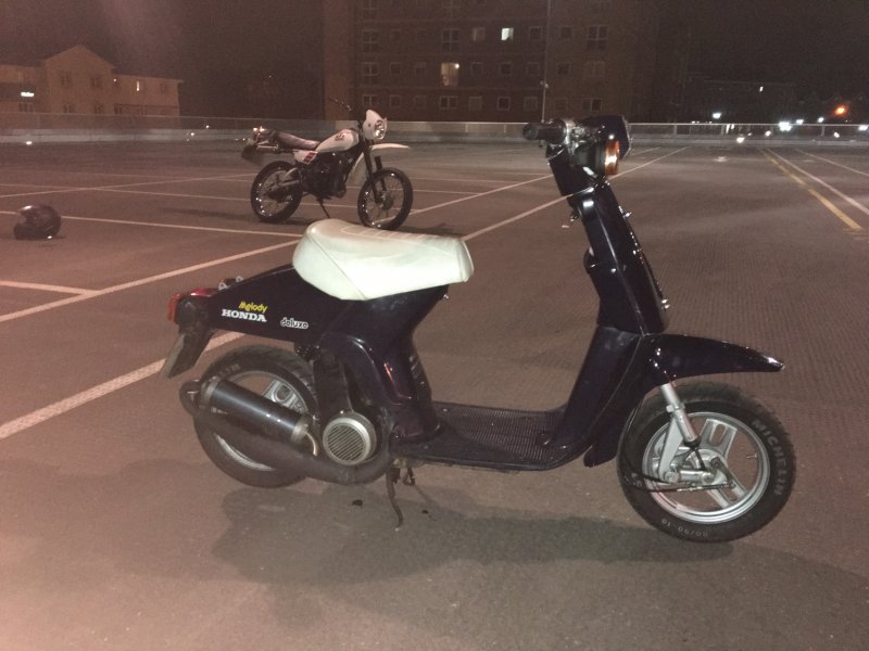

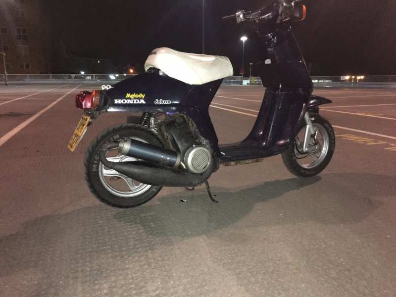

    Here's my tuned Honda melody kx60 reeds 24mm flat slide Honda vision 80cc Conrod on the 50cc crank with a Piaggio 70cc big bore

    i bet that doesnt hang around.... was it a straight swap with the bore? or did the casing need matching and machining? i tried fitting a speedfight sylinder to a honda engine, but the stud pattern was different, so was a daelim/sym one.

    55mph down hill lol had weld engine case and change Conrod and make a 10mm packer plate for bottom of barrel. Now Piaggio 50/70cc barrels fit straight on

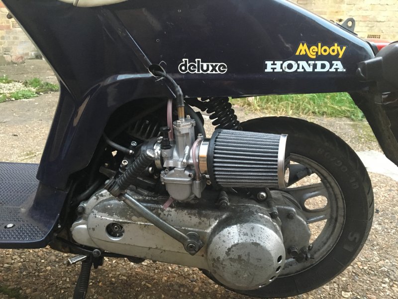

    New car and filter fitted to day runs much better
  10. scubabiker
    hahaaaa love it, that carb is just massive! whats the I/D of the inlet manifold? looks huge
