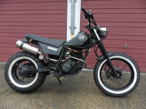

  18. nellyt5
    nellyt5 Member
    102
    bloody hell, managed to get a pic up ,
    there,s no stopping me now
    scootzmadness likes this.
