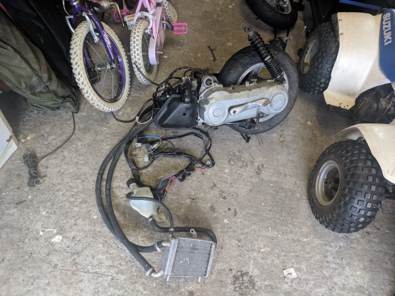

Iv got a complete 70cc Minareli lc for sale if anyone intrested Brand new top end dr70kit Upgraded exhaust 17.5 carburettor
wow ok what jet have you got in your carb? have you done anything with the cvt and what exhaust has it got??
