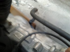

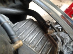

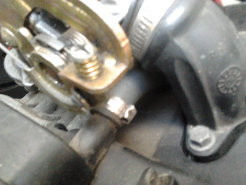

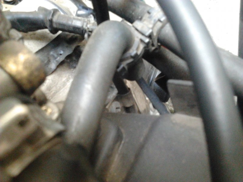

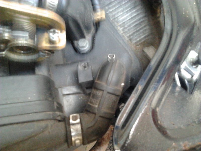

    Get back about 9 this morning,take a cpla 'pics on mine (50cc).Mk.
  2. Mark Emerson Trentham
    #1.Pipe #9.
    #2.End of pipe #9. - clips onto no.5/6,open end/breather?drain?.
    #3.Pipe #9.
    #4 «S.A.S.
    #5/6.Pipe from valve cover.connecting to bacj of air box (pipe that your no.9 aims straight ahead and clips too,with a slight 'L' pointing d/wards at the end.
    (2006 Zip 50 4t).,
    Mk.

    Thanks so much mark that sorts everything out pipe wise.

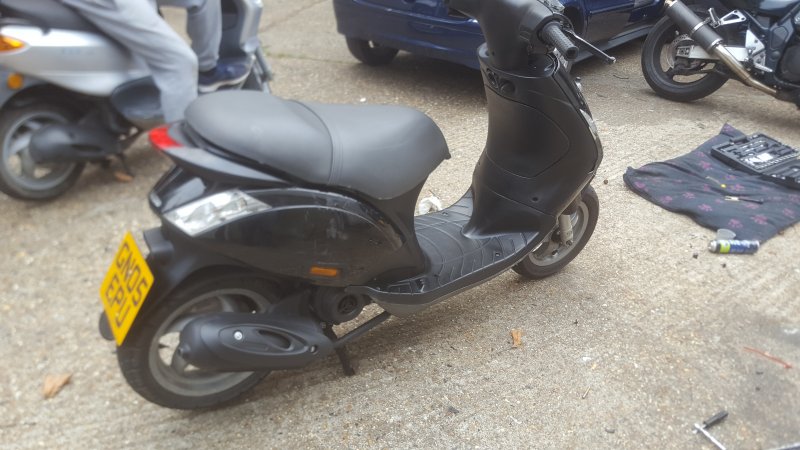

    you will never guess what mark, I finally took the bike apart to look at the piston and rings and man was I surprised when looking at me was a 50cc piston.
    so I bought a second hand 100cc engine to put in my 50 zip. got the engine in which kinda looks stupid cause of the big back wheel and front little wheel. bought everything for the 100 engine including airbox carb and exhaust and it has a 50cc piston and barrel in. I can't believe it cause the engine is bigger then the old one yet is basically a 50 anyway.
    I think I'm going to order a piston, barrel and valves for the 100 and get it running as a proper 100 although tempted to sell it as a good running slightly silly looking 50.
  12. Charlieboy1985
    Charlieboy1985 Member
    31
    my 50/100/50 lol
