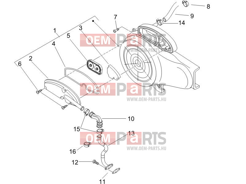

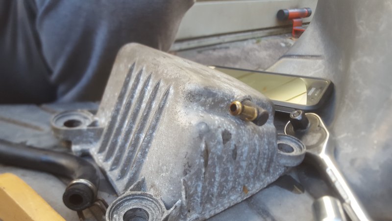

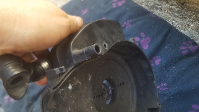

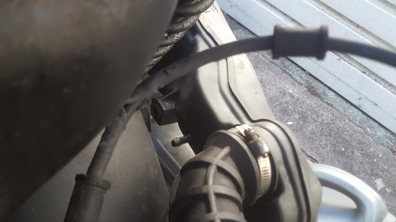

hi guys I need more help. the new exhaust and airbox has helped the engine runs much better I now need to know where a couple of hoses go. the first is on the valve cover it's a hose and I'm not sure where it goes to. I'm thinking it goes to the airbox as there is a spot for a hose but not sure. the second hose is the secondary airbox. it's got the main big hose but there is a spot for another hose? and the second little pipe for the airbox.
Haynes 3492, #1.(Valve cover),'breather hose union'. #2.secondary air system - believe a hose is secured to the reed valve cover. #3.in what position is your third tube.?.
The 3rd pic is for a small tube not sure what it goes to I think the valve cover tube goes to the airbox one? I need to check the reed valve because one hose is already connected to it this is a second smaller hose coming from the sas. Thanks for your help I will take more pics can tomorrow which might help.
Not totally clued up on parametres of airbox assembly.on version 100 - may be 1 day,would'nt mind one as it happens,would expect though it has a drain tube ...probaly focused bottom/towards back. Have a look on my Zip/laters...get back to you. Mk.
