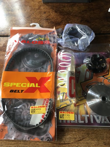

  4. Sam phantom
    Sam phantom Active Member
    874
    I’ve just got the mollossi multivar kit,it is the nuts! Bike feels quick and responsive it keeps it in the power band from start to finish worth every penny

  6. Sam phantom
    874
    No....I thought that about the rollers mine has the 7gram rollers in the kit too and it’s perfect it’s off the mark quick! It’s the kit with the white contra spring, it’s the complete kit that makes it perform perfectly...

  8. Sam phantom
    874
    The belt and clutch are separate
    The whole lot was only £90

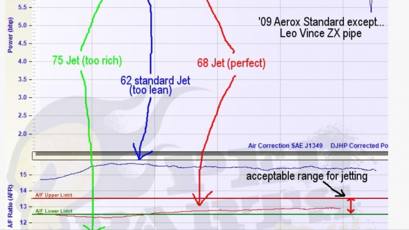

  11. Sam phantom
    874
    68jet is the correct jet for your bike with Leo Vince pipe

  14. AeroxBoii
    AeroxBoii New Member
    9
    Is that a clutch also in the photo? above the contra spring?
  15. Sam phantom
    874
    Yes you have to take the clutch bell off to change the white spring you see in the photo so while your there you may as well change the clutch, as there cheap!
  16. Sam phantom
    874
    Oh and getting a new nut and conicle spring washer for the Variator is best practice
    There like £2 for the pair
