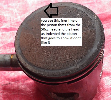

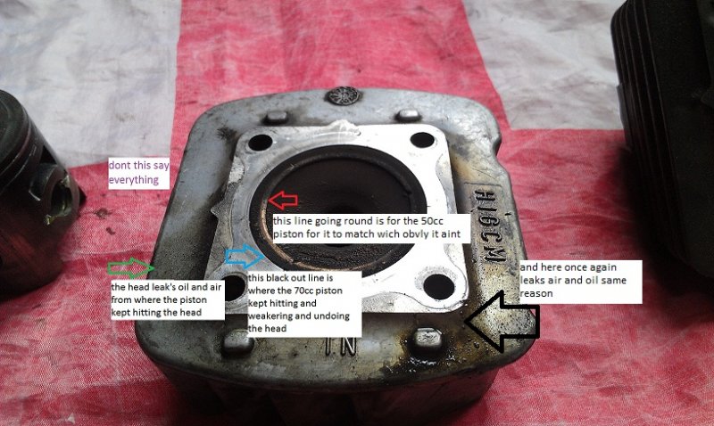

    here you go think you know it all retard try exsplain this, and i am in contact with professionals at pm tuning, top racing, scooter attack, top proformance, and alot of people who go ace cafe that obvly know more then you, so try tell me your b**ls**t

    MY NRG power DD would run at 10,000 rpm with stock CDI.
    you right poiston looks fucked, did you set up the squish band? NO because if you did that cant happen. again that bad fitting/set up

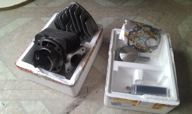

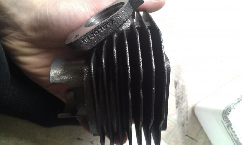

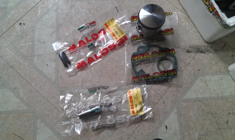

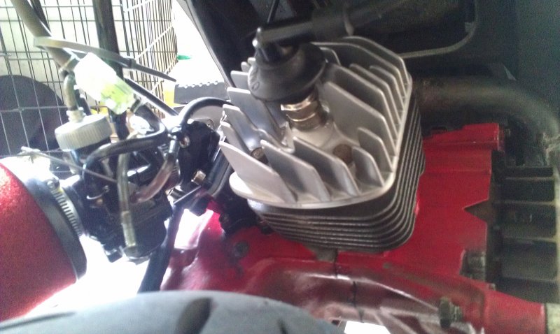

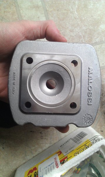

    lol your dum well iv done my malossi kit today and set it up the same and it is 100% better then that shitty aftermarket ebay cylinder the malossi 100% and kid or man go search about AFTERMARKET CYLINDER KITS they are crap and i wanted to see if people was right or not so i brought it as it was £80 and it fucked up coz as iv been told it aint bad setup its the cylinder kit is crap and dont last it was on my bike for 5 6 months and this malossi one smashes that kit all day long my bike has so much power now i love it here some pics of malossi cylinder kit
