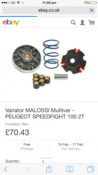

yep scubas bang on here a hi speed variator will show a improvement all round due to the more agressive ramps and the taller drive face the belt can travel up.

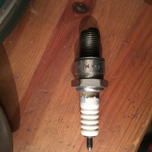

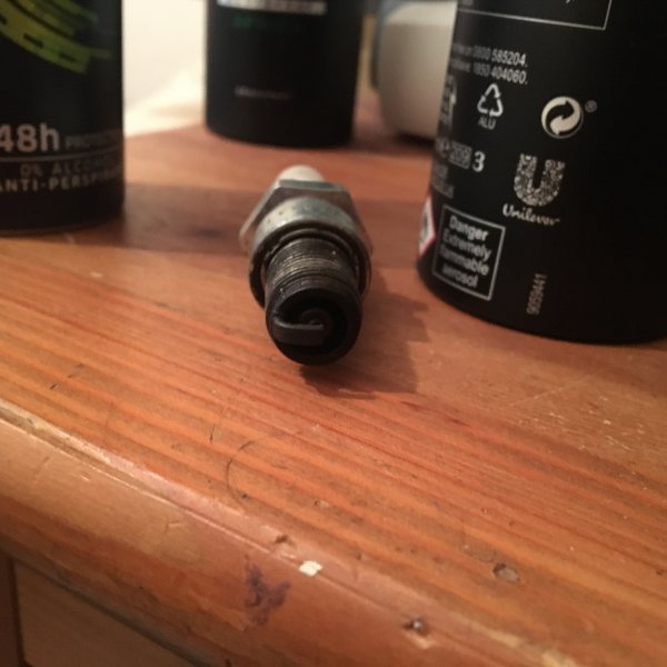

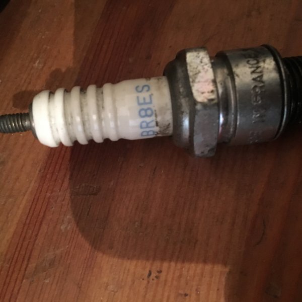

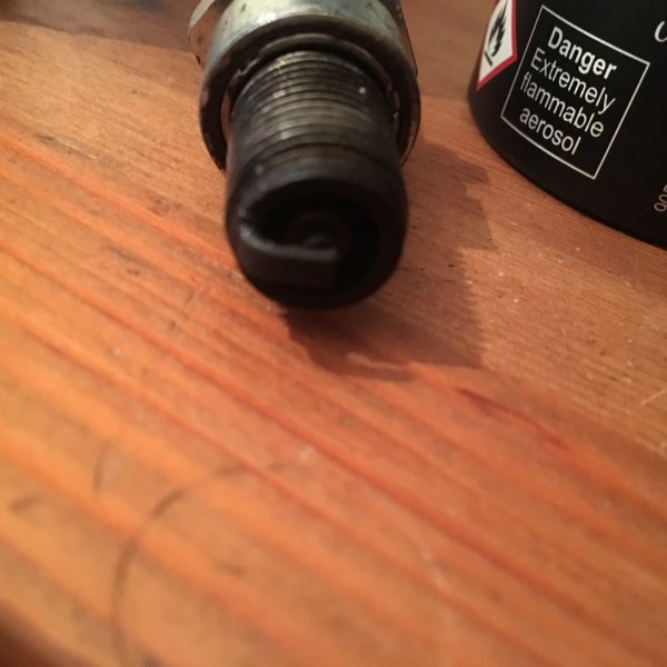

thats an old plug so will be hard to read plug colour, if its a new one that black colour look is telling you the scooter is running rich on fuel /air. see the center anode pin the bridge above it is fixed to the outer ring the top of that outer ring wants to be a nice chocolate brown colour , that colour reading will tell you the bike is just right on air and fuel mix and is burning nice and clean . yes buddy thats the right plug a NGK BR8ES. just before you go riding, pop in a 94 jet see what bike rides like , if im right a 94 could show a little spluttering and bogging, if this is the case keep that 92 jet and dont go down to the 91 jet. you may find the 94 jet gives a little better feel it may not. we dont wanna be very boarderline on the jetting so try the 94 see what its like, if your not happy the 92 is the kiddie thats giving best throttle response and top end
