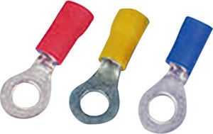

    some wire crimps for connecting to my battery properly

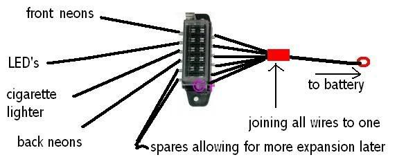

    and i have decided to wire it similar to this...

    solder a little strip of metal across the top of one side if there all having the same feed.. then its one wire in one side an cover the lot in apoxy/chemical metal/filler so it cant possible break off/earth out. 6 lives going into that is just pointless
  9. sc_bk
    sc_bk New Member
    94
    TBH I'd stick all the neons/LEDs through the same fuse as they won't be using much power.
    And depending what you're gonna power off the lighter socket, you might wanna run it's own cable from the battery to the fuse
