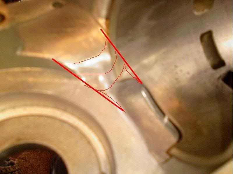

  4. kyle1b1
    probs one for minor this :cool:
    right when the barrel is fitted the bottom bit of the barrel kinda pertrudes the inside of the cases restrciting flow.
    shit pic but you get the idea can the botom bit of the barrel be cut back abit ? :D
  5. nrgandy
    yes kyle match it up so you have a good flow
  6. MiNoR cOnFuSiOn
  7. kyle1b1
  8. kyle1b1
    right idea?
  9. kyle1b1
    or was you just showing where to go with cases and not bottom of barrel ?
    just come to me :rofl:
  10. MiNoR cOnFuSiOn
    both... theres more to it than jus cutting them, tho... fflakey flakey
  11. kyle1b1
    yeah was thinking that best leave the barrel for now :rofl:
  12. nrgandy
    is it a good idea to do this minor are there any down falls and i should be ok with flac i need to get barrel relined anyways so flakeing wont affect me today will it
  13. kyle1b1
    is about 100 quid aint it for it re-plating :msn1:
  14. MiNoR cOnFuSiOn
    if you pay somone who sends it off to pay somone...
    should be around 70 quid from a vendor. MAX
    as for the cut.. just use a sharp disk at a low speed on the lining first... cant flake if its already cut (it flakes from cutting angle or when breaking through.. keep the cutters square to the cut surface and cut from the front wiht LOW load on the tool and it wont flake...)
    deffo a good idea to do on any barrel.. piston can flap about a bit more with less skirt area tho of course.. with every improvment theres a loss... ALWAYS (the aim is to iliminate the loss not just make power.. with the piggy waterpump's being absoloutly shit the heat made by tuning is a serious factor and messures MUST be taken to keep the heat down/replace the pump)
