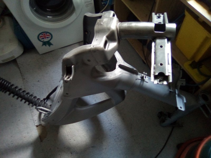

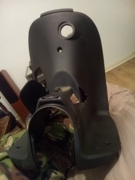

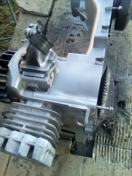

Shot some poundland grey primer on the frame to slow the rusting down.fed up sanding metal laterly.got a few bits on the bottom to do but two more 250ml tins should see me good till it dries and i can use the silver and see what it's gonna look like.using the poundland silver wheel paint for the inside bits as nobody's gonna see it and silver is silver in the dim underbelly of an ice frame. If it looks crap Ile wack some of the other on it..

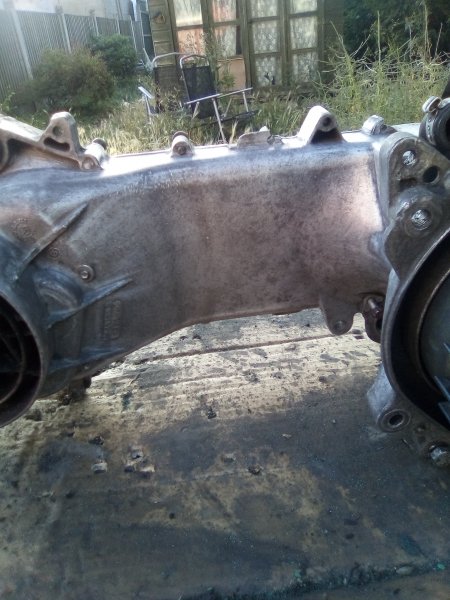

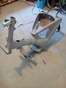

Been smothering bits in paint again.the over spray on the black bits is intentional.gonna need to rub the dodgy bits down once it's dry and do underneath but it's the first coat of silver and it ain't too bad.lol.

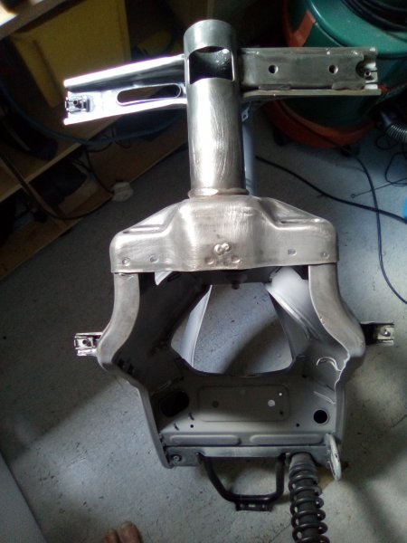

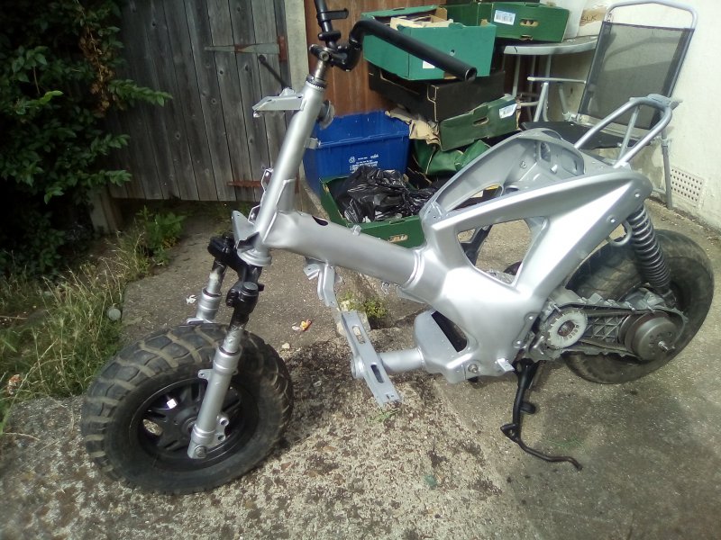

been drowning the frame in silver paint last two days and got enough on to do a bit of rubbing down for a final top coat or two before the laquer goes on.did a few more black bits but i put them away so no pics yet of them.maybe later.bought a compressor last week but the one i ordered wasn't the one they sent.i ordered a little 24ltr 5cfm one...they sent a 100ltr 15cfm.im not complaining but it ain't that portable..£250 price difference but i need to move it about..oh well ..have to go under a cover outside for time being.

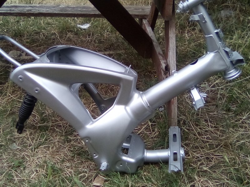

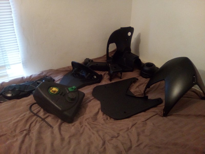

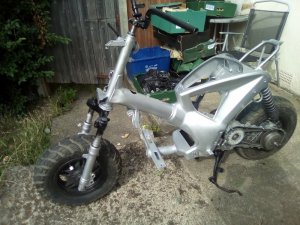

Pretty much down to the wheels,cables and wiring bits now.all the plastic,frame and odds and ends are done.may need a headlight later as mines a bit black on the big plastic surface.bulb reflector is ok.maybe wangle a paint brush in and silver it up enough to distract the tester.i could be having some of this together by next week.bloody hell.
Well.first i clean all the surface then repair any bits and sand it down gently with 1200 wet n dry..then clean it and bang shit loads of paint on it in thinnish layers till there's enough to rub it down very gently with knackered 1200 wet N dry.i don't put any pressure on the paper.just fold it and let the tension in the folds be the pressure.if it bends I'm going too hard..lots of water too..i got bugger all to do all day so I'm bored to tears sometimes.i need to get out more.really.think I've used so many rattle cans to do the primary coats i should have bought the compressor in the beginning and saved money buying normal paint and thinners.£60 ish on cans .still not finished but poundland/wilko Matt black is £7 a 500ml tin.good thinners £15 LTR...could have saved a good bit of time getting it right first time and not have to rub down all my cock ups.oh well.got a compressor now so if i can get the last final top coat on with the control i got over a gun i should be laughing.HAHAHA.see...i need to get out more..

finally got the engine in and it's movable.couldnt remember which way the rubber blocks and mount went but sorted it all in the end.cleaned and rewrapped the loom yesterday so that's nice and unsticky ready to go on soon.next thing is sort bolts and clips for panels and get the throttle cable made for single run straight to the carb.silly adjuster on the switch end has broke so gonna have to drill it out and sort a suitable replacement.one long run of inner and outer with the right size nipple at grip end to start..new pads and s/h hydrolic pipe on its way.no excuses now.
