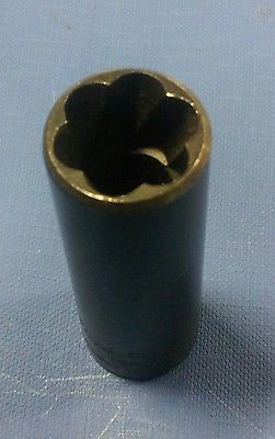

    I usually try the following but not necessarily in this order...
    see if the stud will turn out of the head with the remains of the nut in situ and then deal with nut afterwards
    give it some heat,
    soak with plus gas,
    grind the sides off the nut with a dremmel to ease pressure on studs threads
    nut splitter if theres room
    or try a twist socket like this or see if a smaller size socket will hammer on the remains
    If all this fails then burn it off with the cutting torch
