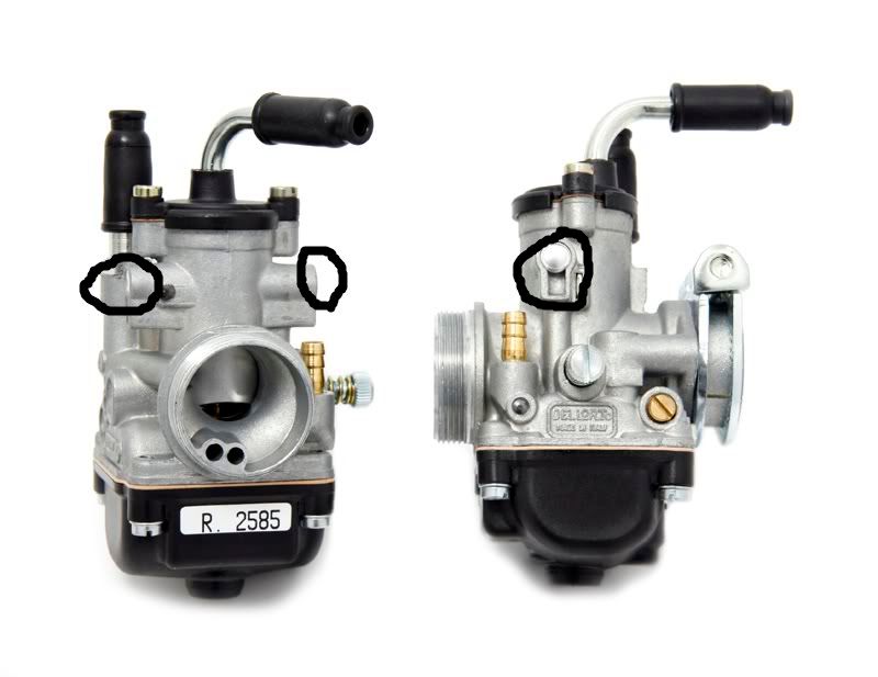

    bit complicating i know, but ye, most overflows point down on the carb so there easy to spot.. if your unsure ether check the dell website or throw up a picture and we can mark them all out for ya

    marked the bits in question but they are blocked off on the pictured carb. I have the fuel tap vac on one and the other is open
  12. MiNoR cOnFuSiOn
    the carb pictured has no oil/vac lines, just the fuel in.... the things you have marked are overflows for the float, do NOT blovk these off... do NOT try and attach vac lines to them.... how this even runs i dont know, the only way it could possibly work is if the tap is busted...
