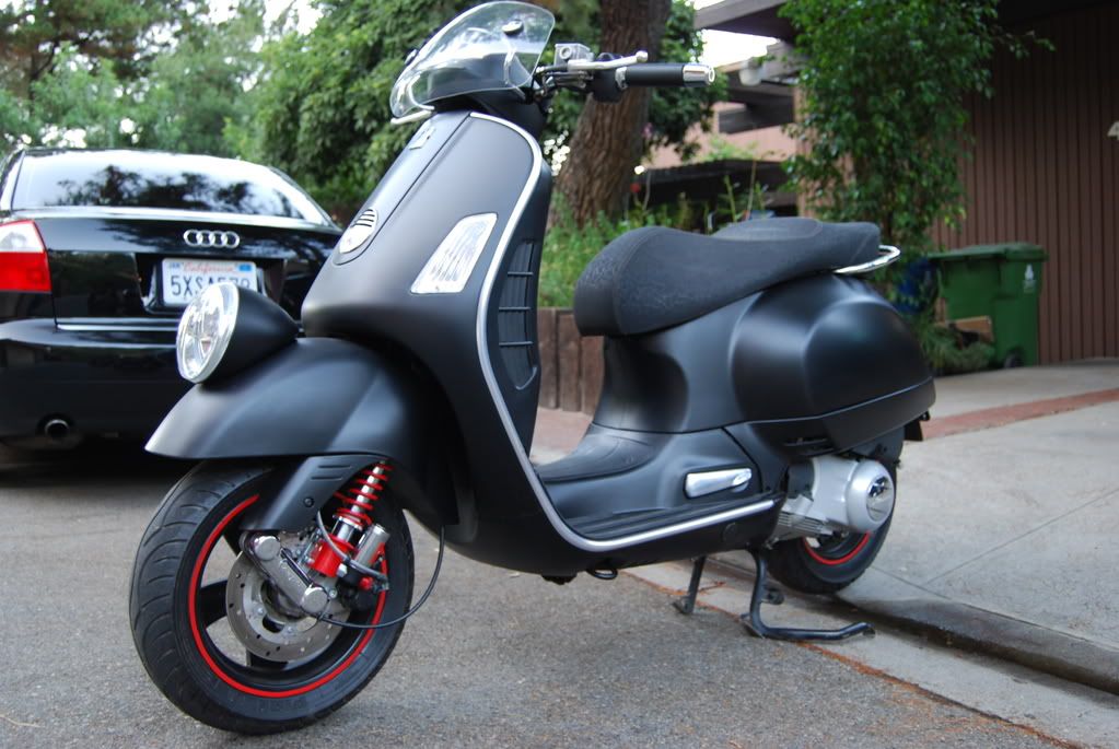

    you could do it a gunmetal grey gloss.... would look different to gloss black (not so bright) so will give the same look your after wiht the matt black.... matt never looks the colopur it should. colour isnt really colour till its got clear :) matt black looks so different as glos black will carry a colour wiht it (usually looks silver/blue in parts once its polished out) where as the grey i recon if dark enough will look close to the look of the matt black once polished out... oh and it will be shiny :)
    uptoyou att he end of the day... its your bike, go look at some paint books in halfords (ask at the paint and numberplate section) you may find you settle on somthing completly different to what your thinking. theres always somthing that will catch your eye.

    noob or not noob paint job that looks lovely and inspires me more to do the matte. sorry minor :p
  4. MiNoR cOnFuSiOn
    hey, if thats your thing go for it.... just a shame you set your hights so low.

    few pics from today.
    thats jut dust on the front of it there but as you can see the bit near the legshields could do with another coat, theres a few runs aswell but youd have to be looking for flaws.
    overall im delighted with how it all turned out bar the few spots i need to touch up.
    I think that i thanked my lucky stars when the engine actually fired up first kick :p
  8. MiNoR cOnFuSiOn
    i still see dents..... well, flat bits where thers oibviously fgiller and were dents... use a sanding block next time and go wiht the direction of the pannel. cant say i like it... its how mine was when i bought it... lookes bodged/hurried. but then i knew it would.... its matt black.
    still, good on ya, getting on wiht it thas the main thing. glad it fired right up aswell. always nice when they start first time.

    definatly shouldnt have gone with matt black, but still a nice job. ;)

    I do like the matte though and afterall ittl be me riding it, nonetheless it is a rat after all.

    cool man.. apart from that flat spot on the front, it looks like a half way decent job.
    yeah... i would have used a rubber block to sand back the bog....
    i know the painting is the fun bit, but 90% of the work is in the prep... its all a learning experience.
