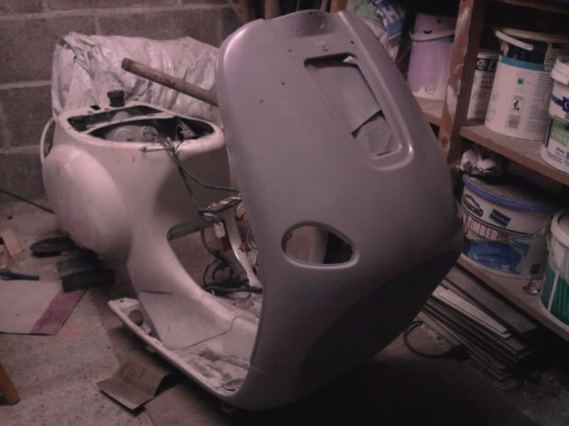

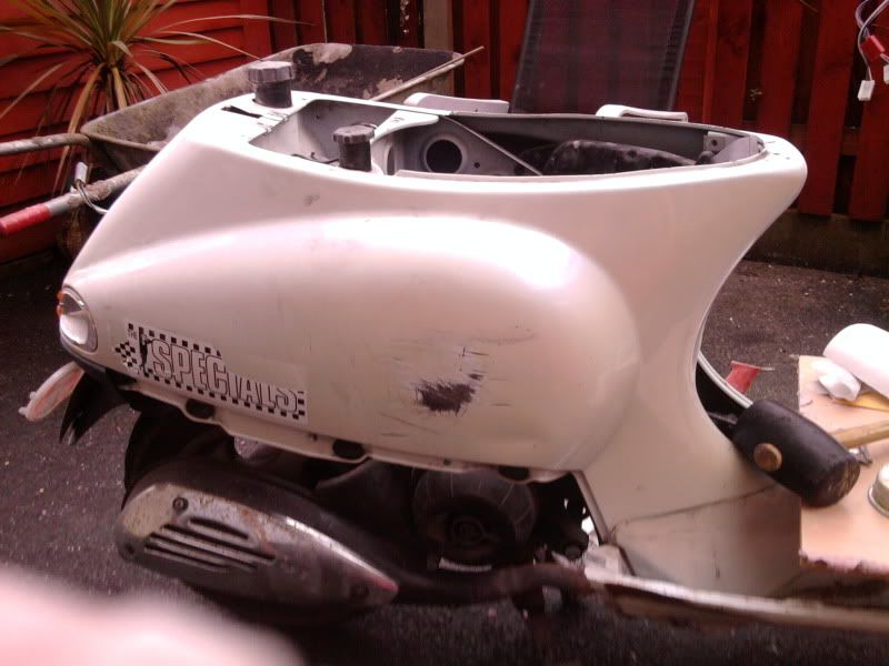

    [​IMG] sanded, filled, the thing i was using to spread had a bit of hard filler left on it meaning it didnt all end up perfectly smooth so i cleaned it and skimmed a very light coat of filler over the imperfections and such of the last coat and now it looks very nice, will probabaly call that section ready for some primer with a wet sanding of somthing light like 400 grit.(no im not going back to bare metal bit ill oprobabaly primer the whole bike anyway)

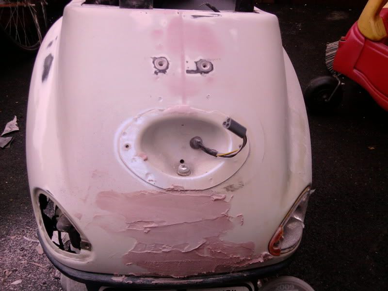

    next up is the back end of the scooter
    [​IMG] nothing needed to be done here but i decided to fill in the body seam anyway to give the scoot a more streamlined look, took the pic before sanding the bottom section, and it willl need quiet a bit because as you can see the layer of filler is a bit too thick

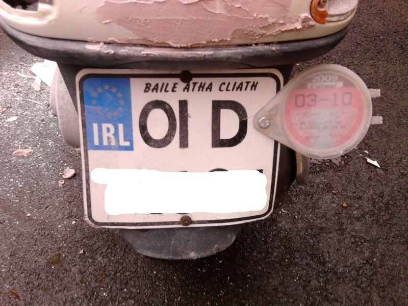

    an irish reg plate for anyone who cares. 01 is the year and D is where it was registered (Dublin)
    if anyone knows how to get this mudguard off let me know because im stumped.
    the part of the scoot im least looking forward to doing as its a bit of a mess.

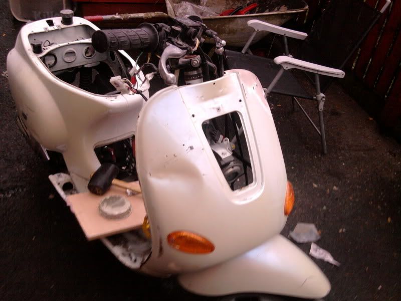

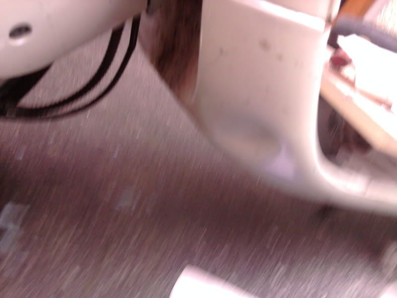

    and finally a couple of pictures of the other dents.
  7. MiNoR cOnFuSiOn
    mudguard comes off from the inside.. there are 4 little holes at the bottom of the metal bit ... may have to take the seat inner/fuel tank shield off (under the seat obv)
    those dents all look verry familuar for a vespa LOL remember to use a nice round peice of wood and a hammer to remove them. (broom handle works well if you cut 8" off the end an use the round bit) dont just bung them full of filler as it will just fall out...

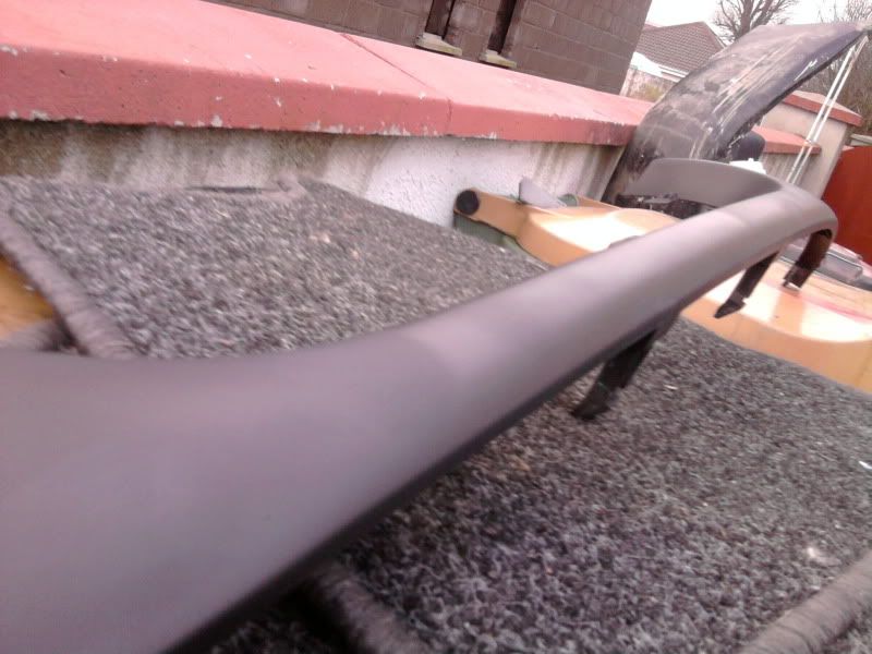

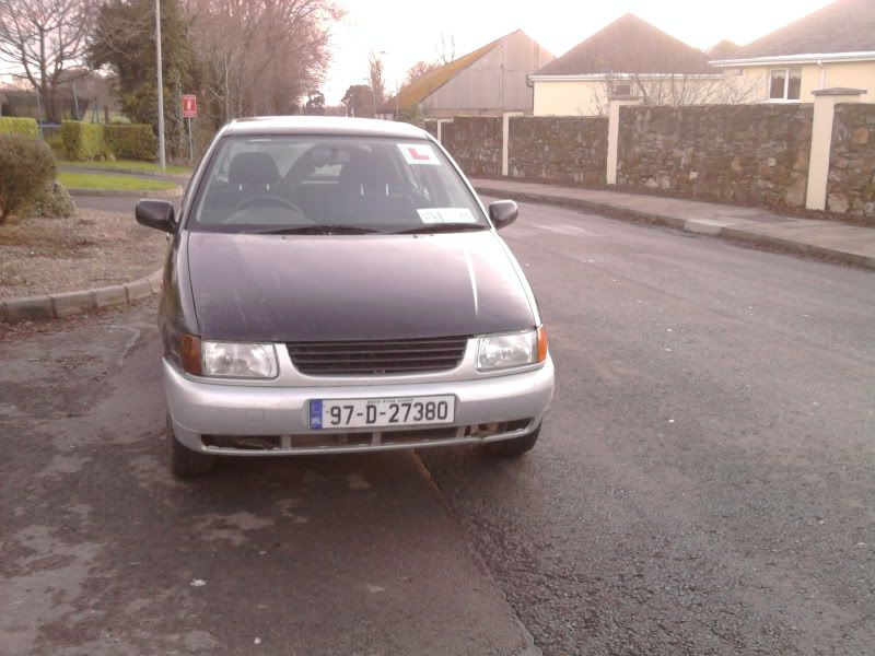

    well the past 2 days has seen me working on my polo because my cousin said he will buy it if i respray the bumper,
    [​IMG] how it looks repaired after the crash.

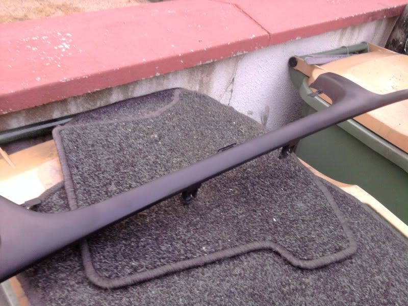

    i dont have a picture of the finished job yet because paint is still drying and whatnot, me and dad sprayed it in 2 afternoons (1 of which was a strong enough breeze) outdoors, plus neither of us had done any proper painting before but there wasnt any dust because it had been raining, its all done now bar a final coat on the bumper but the grille surround is done. painted matte black like i will be doing with the et2, which is why i am showing this.
    there is some minor orange peel.
    going to be doing the et2 in a shed and taking time to do it so with this looking good enough (and i thought it would be much worse) i reckon i could get the et2 looking very good(plus ill have help from a friend)i dont expect it to be perfect though since painting the bumper was the first thing ive ever painted car wise, i promise pics of the finished product.

    bit off topic really... but wiht orange peal, aslong as the paints not flaking/reacting you can just keep building the layers then do some 1000 wet and dry once its all dry, this gets it all nice an flat, then go to 1500 and then go to cutting compound (go fucking gental wiht the paper mind and use LOTS of water) will soon buff flat... if however its metalic your best bet is leave the peal, spray clear over it then flat the clear, metalic's tend to go real patchy/stripey when you wet sand them.

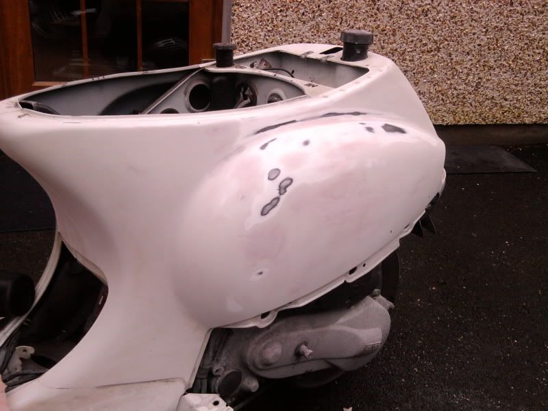

    not much of an update, beeen doing more sanding and knocked most of the dentage out but there not shallow enough to be filled just yet.
