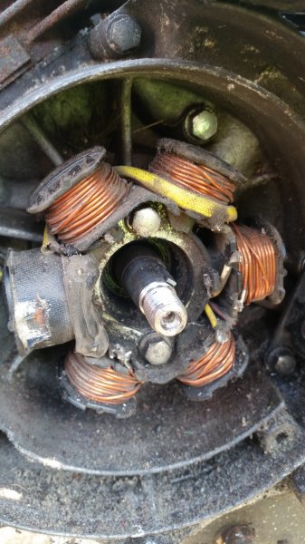

  16. bmunro21
    bmunro21 Member
    55
    Found the ignition coil and no wires are detached (my coil has two wires?) So I took my stator off to see if I had fitted it incorrectly and found this... 20160512_084545.jpg
  17. bmunro21
    bmunro21 Member
    55
    Okay guys uve replaced my stator with a brand new one, still no spark
  18. Merlin
    Merlin Old School Biker
    2,305
    2007 TKR WRC 50
    Does the headlight flicker if you turn the bike over? Can you tell if the alternator is powering the lighting circuit (head and tail lamps)?
  19. Stevep
    Hmmm...............
  20. bmunro21
    bmunro21 Member
    55
    Hi sorry for the slow replies, yes my headlight does very dimly flicker when I try and turn it over
