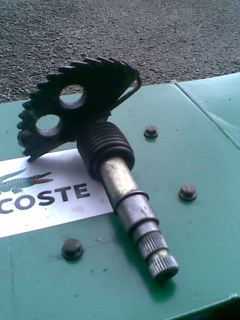

    i got the case off, it was caught on the kick start, it s a bit rusty and needs some effort to get it through, Put my new rollers in got the belt on but after that realised the kick start was out of place. when ever i get it to where i think it needs to go, i try and put the case back on but because its such a tight fit through the gap it disrupts it again. :confused:

    209
    Do you reacon it would be alright if i used my dremel to sand away a tiny bit off the diameter of the kickstart pole?
  7. MiNoR cOnFuSiOn
    just sand with 800 sandpaper till the surface rust is off.. they tend to swell when they rust so take all the rust off and it should slide in.. bit of grease on there when you re assemble ;)

    So i sanded the kick start down but it still wouldnt fit because when ever i had it placed right, and put the case back on, the kick start pole would be at the wrong angle so as soon as i moved the case to the bolt holes its fell out of place. Eventually after trying for ages the kickstart gear fell off and i cant get it back in, and this bit came out too. Do i need them in there if i dont intend on using the kick start?
