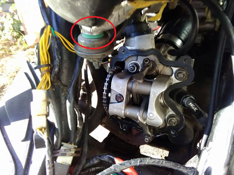

    fairly sure thats not normal hose pipe above petcock secured with hose clamp :confused:
