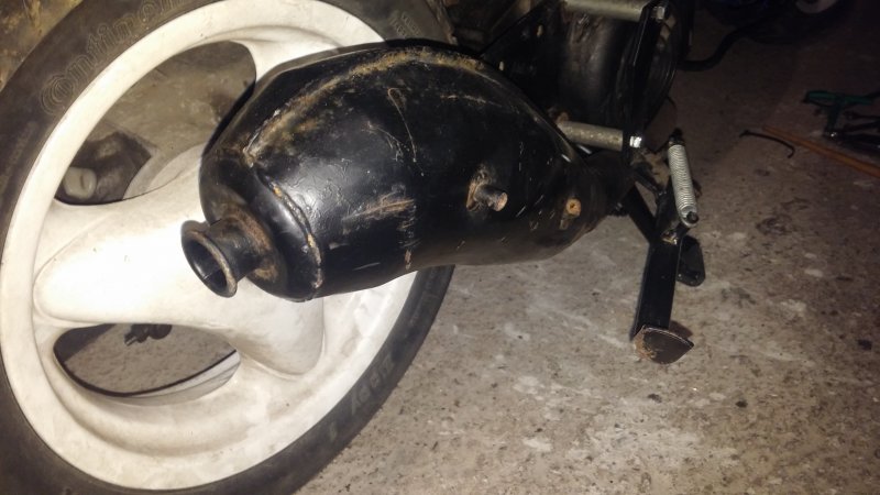

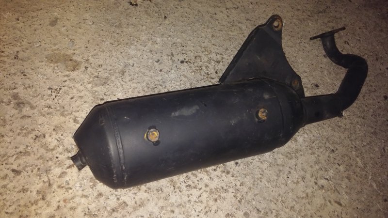

Hi Thanks for replying. I have a 1998 yamaha yn50. It was running on an standard air box with no filter in....i didnt do that hence why i am now struggling. I have put the air filter back in and it is slightly oiled. That is the exhaust thats on at the moment. Someone said it is a performance one but i beg to differ. It doesnt say anything on it. Hope that helps
72 will definitely be too large now you have the correct filter fitted. But 52 sounds a little on the small side, if I were you I'd buy a multi pack of jets and work my way down from 62 until it runs how you like it
